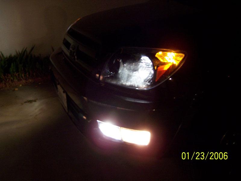

this is what i got .... at night w/o turn signal ....
