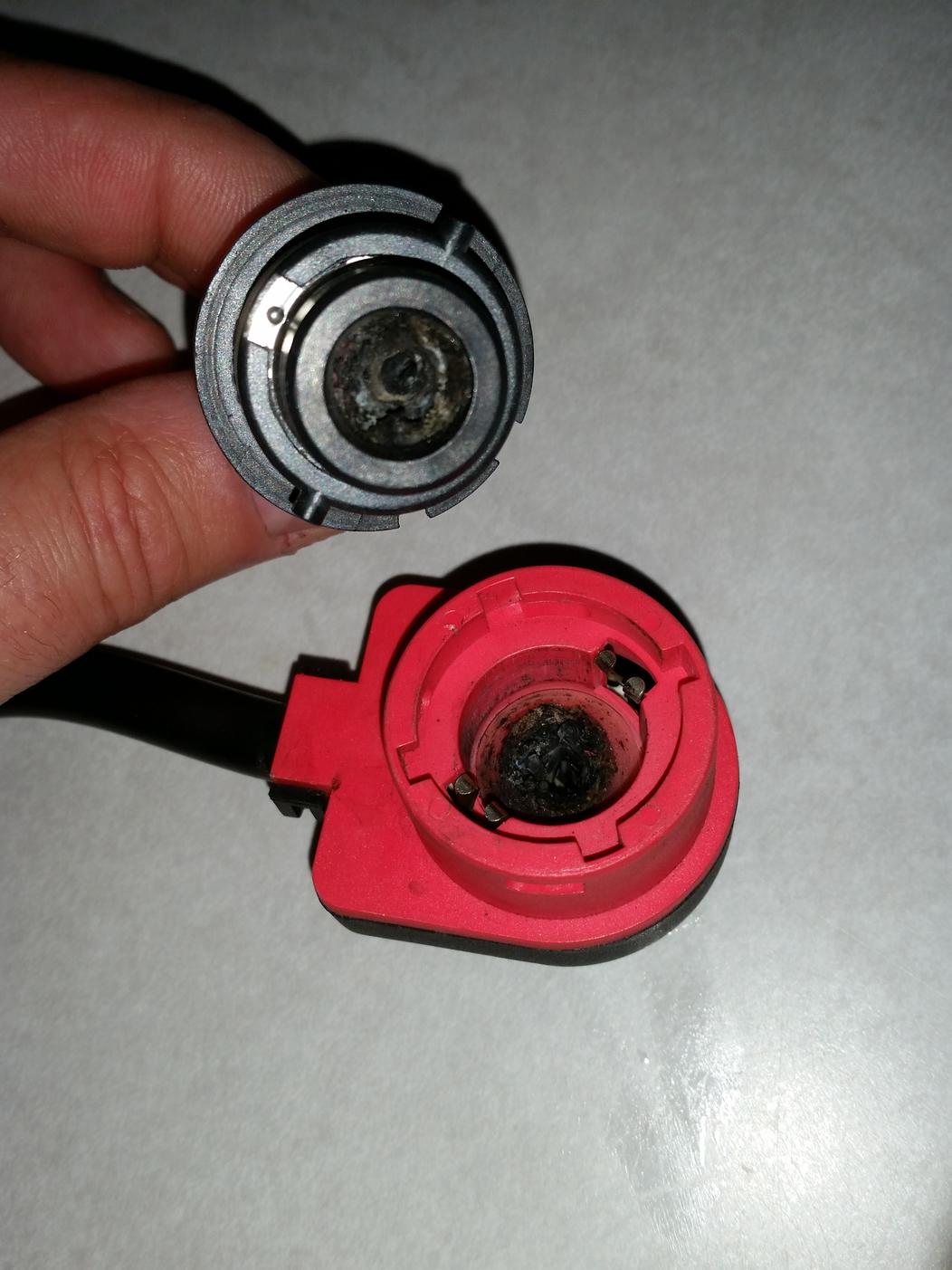

I did a projector mod using DDM parts back in September and noticed some weirdness that I planned call them about until I lost my driver side headlamp on Friday night. Now I have a warranty claim.
Pulled it and noticed the socket inside the harness (connector) and the bulb socket were completely burnt out! Pic of socket and bulb attached.
The bulb itself looks fine, not burnt out - what a strange failure. Hopefully DDM stands behind that lifetime warranty, that's the reason I used their parts.

What I realized must have happened was bulb/connector junction was not sealed and water must have gotten in and shorted it out. I went to the plumbing department of the local OSH and picked up a 10 pack of washers that I test-fit to a bulb in the store, both in diameter and thickness.
I installed a washer on each bulb and tightened the connector back on and have been driving for over a year without issue.
Maybe the DDM kit had bulb washers and I overlooked them, but there was nothing in the instructions about this potential issue or the need to insulate, but it makes sense.
At least now I have spare parts and the knowledge of why the issue occurred.
Just wanted to give closure here.
INSULATE YOUR CONNECTOR TO BULB CONNECTIONS
