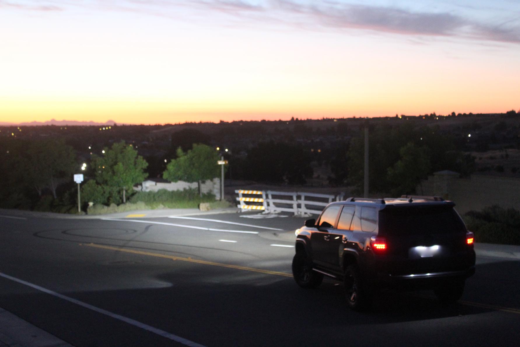

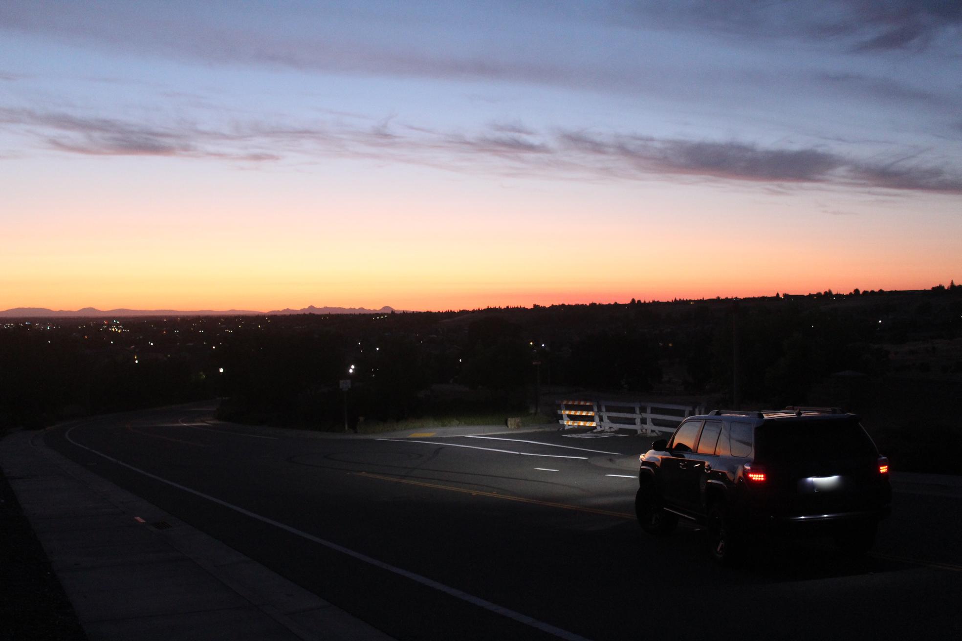

You don't have high beams on the 2nd pic do you? Why is the led so high? It's lighting up the tree vs. The hid where it actually uses cutoff of projectors.
Sent from my SM-N910T using Tapatalk
What? The LED bulbs are only in the high beam only from what I can tell. So that would explain why it's up in the trees.
High Beams are not projectors, light path is the same as you standard incandescent bulbs you have now.
Ah I didn't click on led link. So 2nd pic is hid + led. Ok sorry! Hmm I may pick this up in a couple weeks.
Maybe it's just me but seems the led's put more focus down middle? The sides are much dimmer compared to the hid's as well. I've done a few retro in my time and love my hid. Only in projector setups of course. But I love how wide the light can spread out. Hopefully as evenly as I'd like.
Again, only the lows are projectors. These are just LED bulbs in place of the standard incandescent bulb. Light path is determined by the reflector in the housing and not altered with bulb swap.

Again same as before 1st shot lows HID
2nd Shot High LED + Low HID
