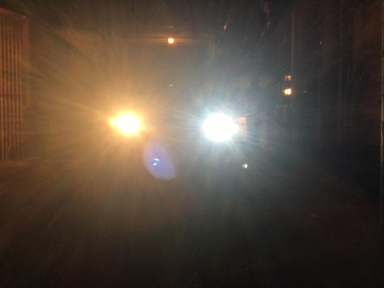

Ok guys/gals,
This is what I have since receiving my DDM Tuner Saber LED's today.
First, here is a photo of some Morimoto XB LED's I had previously installed on my T4R and was not quite satisfied with the performance, but that is not why I am referencing them here.
The reason I am referencing them is because they were oriented to fit in the 9005 socket and have the LED's at the 12 & 6 O'clock positions. The LED's could not be moved on the fixture, I will explain later.
See Photo:
152116d1428112940-anyone-has-actual-experience-trs-morimoto-xb-led-headlight-drl-highbeam-trs-morimoto-xb-led-headlight-installed.jpg

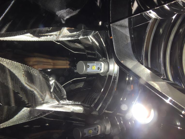

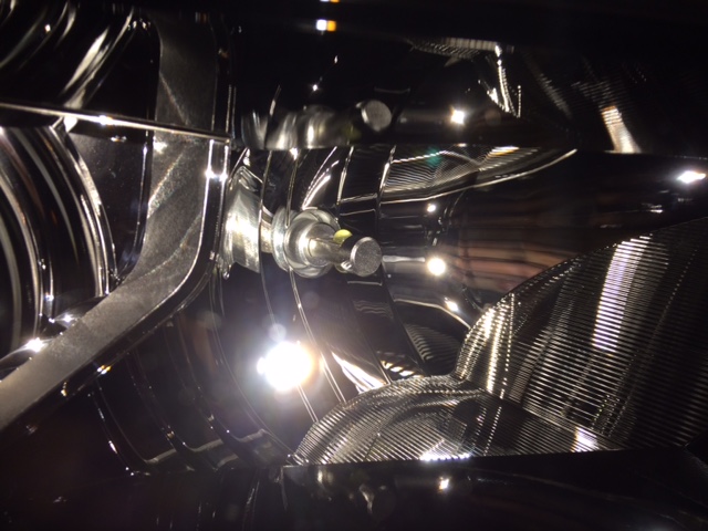

I received the Sabers and found them to have a set screw between the socket tabs and the fan. These can fit H10, 9005 & 9006 so I assume one may need to adjust which direction the LED's face or oriented depending upon the reflector.
When loosening the Allen screw and turning the fan while holding the socket tabs, one can face the LED's however one chooses. (Remember I said I would explain later :D)
So, one LED fixture was set to be at 12 & 6 O'clock and the other one was set to be at 9 & 3 O'clock.....
Being that the previous Morimoto's were made for 9005 sockets and faced 12 & 6 O'clock, I rotated the passenger side Saber fixture to that position and locked the Allen screw down.
Install complete after zip tying the small ballast for the LED's.
Color and intensity is superb IMHO. Output exceeds the 9011 MOD High Beam!
Mind numbing, mosquito singeing bright which a dusting of the suns rays!

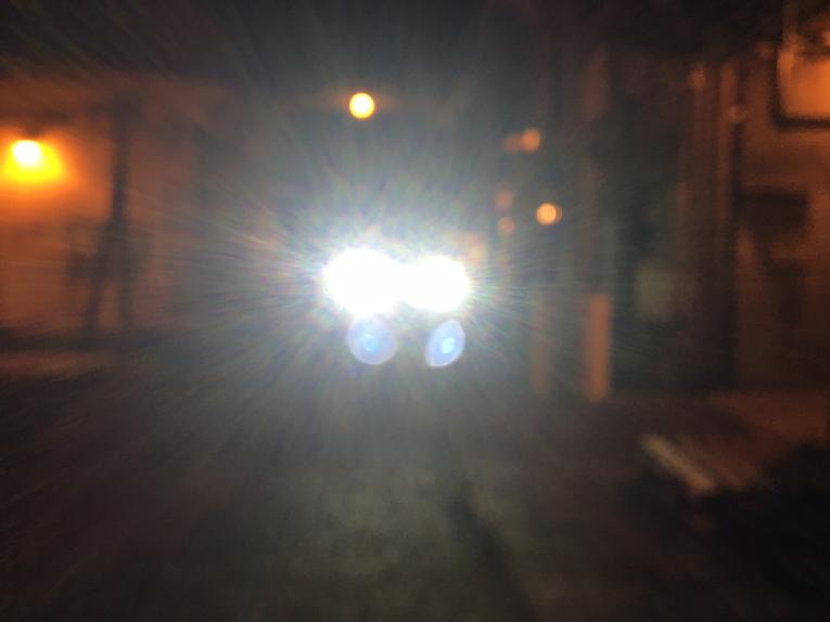

In the following photos, I disabled the LOW BEAMS so they would not come on and ran a comparison.
Excuse the grainy photos taken from my iPhone.
EDITED: See Post # 58
Photos in this order:
LED Drivers Side/ 9011 Passenger Side
Next 2 photos are of the high beams only
Proper orientation of LED in housing (Edited)
Side view of Low & High Beams on (Edited)

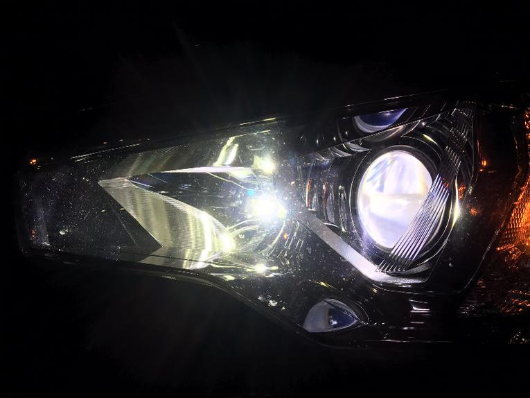

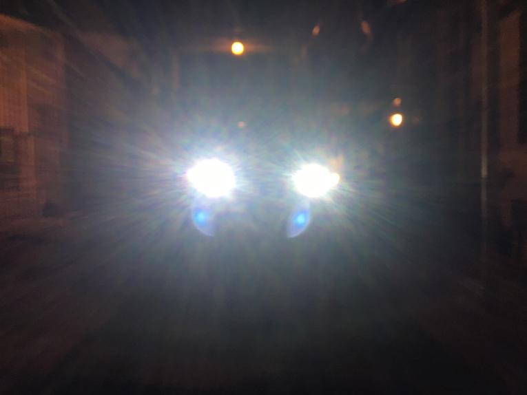

The very last photo is with low and high beams operating, photo taken from the side of reflector.
Side view of the drivers side LED position in housing
Low and high beams operating, photo taken from the side

Now you've got me thinking of the rotation and led direction would in fact change the beam pattern in our reflectors....
Hummnnnn....
Told ya the high beam was impressive ;-)
[MENTION=107788]Trail-AMMO[/MENTION],
I turned my LED's 90 degrees (like yours) to check the difference in output....
And......
Just preliminary test in my garage, I am not getting near the light scatter upward and downward now. Which I think is a good thing.
Real time testing on the back roads will generate a better comparison.

What a Difference!
Latest Update........
What a difference the orientation of the LED's made in my housings!
Thanks [MENTION=107788]Trail-AMMO[/MENTION], you had it correct from the start.
After turning my LED's to 9 / 3 O'clock position, they throw light forward considerably farther down the road and still get the flood that high beams should throw.
This has got to be one of the best lighting upgrades, save the LED LIGHT BAR!
Glad Trail-AMMO had his turned in this manner and glad I ran across the VLED's description of how to face the LED's!
I suggest anyone that installs these, turn them to this 9 / 3 o'clock position to achieve maximum forward light output from your LED's.
