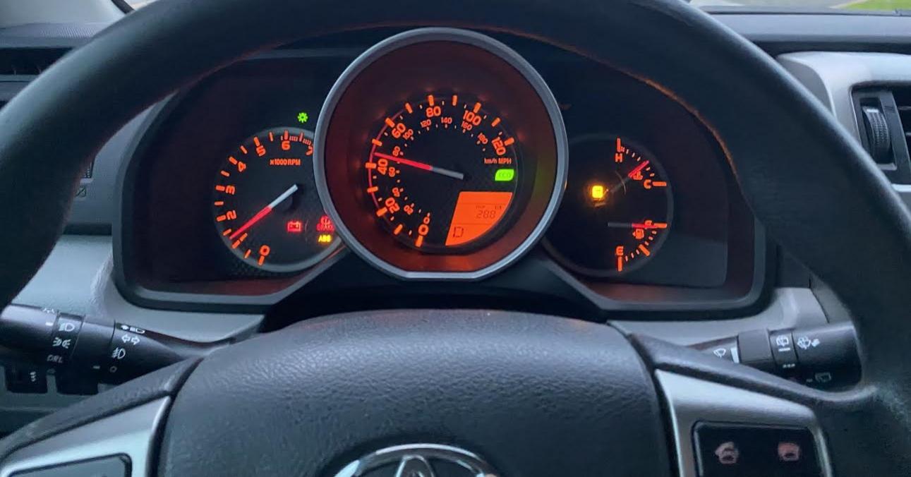

Hello,
2011 4 Runner 200k Miles on it.
The vehicle has been pretty reliable. Yester I noticed a whine coming from the Engine compartment, which was audible at idle, not so much at speed. I though this was possible a PS pump.
Anyways today, started right up fine, drove for 5 miles, then the dash lights went on: battery, e-brake, abs and TC. When parking it the headlights were very dim. But when it was parked it died. Did not start after that at all. (no clicking starter etc). When parked I noticed a very bad burning electrical smell. Checked under the hood no smoke. Checked an hour later and noticed that the alternator pulley was incredibly hot to the touch.
Battery is an odyssey, and I checked the terminals, they are clean.
So has anyone else had such issues? It seems to me like a bad alternator?

With the engine off, I would loosen the serpentine belt and remove it from the alternator pulley. Then spin the alternator by hand - it should spin freely with very little force. It should not make any noise or feel like it's grinding. From your description, it sounds like a bad alternator bearing, that may have damaged the alternator. Sometimes they squeal too. You can also smell the alternator to see if anything is burnt. If so, then I'd just replace it. No sense in trying to replace the bearings (if you could locate a rebuild kit) if the field windings have overheated and burnt.
Also, with the belt loose, check all other free spinning and idler pulleys to see that they spin freely.
simplest solution is to jump the battery and see if the alternator is charging it. alternator should be putting out ~14v. the dimming headlights is a big clue
the other lights lighting up the dash, also a symptom of failing alternator. as for the burning smell, perhaps you have a valve cover gasket leak that started dripping onto the alternator or somewhere else hot?
Update:
This ended up being a faulty alternator that took out the battery. Replaced them, and now back in service.
