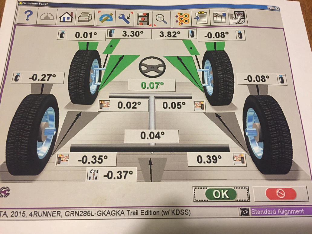

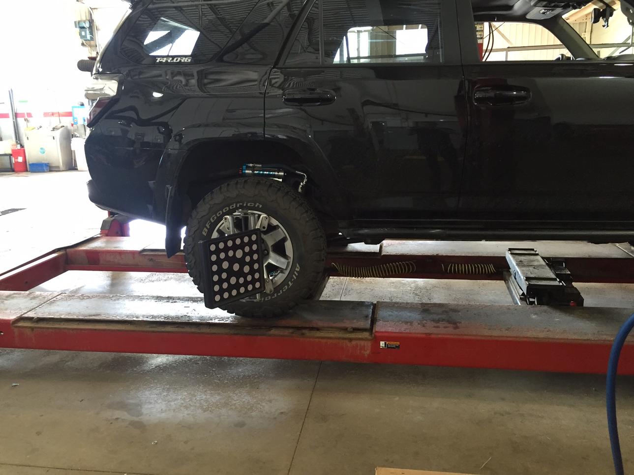

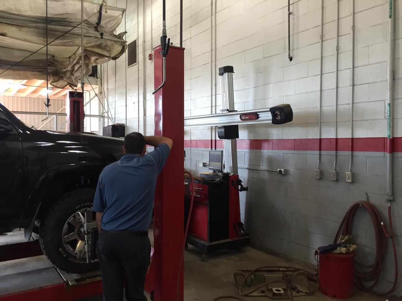

Yeah, totally jacked my 4runner up like whoa... They didn't even try to put it on the rig, just said the big lift on it meant the "numbers wouldn't make sense."
I said "there's no lift" and he replied "I know what I saw." Yeah, okay dude...

Firestone spent over 2 hours & 3 techs just to get caster from low 2's to almost 3 today. Camber is close to zero too. I have bilsteins set to 1.75 and a 1" rear spacer. Mine was fairly squirrelly at speed too. Don't expect too much from them; they don't want to do it unless it's easy.

I keep seeing stories like this, and I just don't get it. Whether you have any lift or not, there's really no horribly complex "secret" alignment procedure for the T4R, and there shouldn't be any need for a Super Duper Expert Master Alignment Tech to do it.
There are only 3 adjustment points for alignment on the T4R. The rear cam bolt on the lower control arm adjusts caster. The front cam bolt adjusts camber. The alignment tech might need to juggle between them a time or two to optimize the settings since adjusting one setting will affect the other, but 2 hours to "get" a degree of caster? Absurdity. Unless I'm missing something, maximizing the caster is a simple matter of turning the cam bolt until the adjustment arrow is pointing sideways. That's it :shrug:
The 3rd adjustment point is toe, which is adjusted at the tie rods after the caster and camber are set.
My first post-lift alignment took about 20 minutes once the skid plate was off. I swear, I wonder if most of these stories of "difficult" alignments are based on the tech being too lazy to remove the skid plate to gain access to the cam bolts.
Mind you, I'm no expert, and If I'm wrong about this, I hope some alignment maven will come along to set me straight. Otherwise, it seems to me that what I'm reading is mostly voodoo. As I said in another thread, it ain't rocket surgery.
