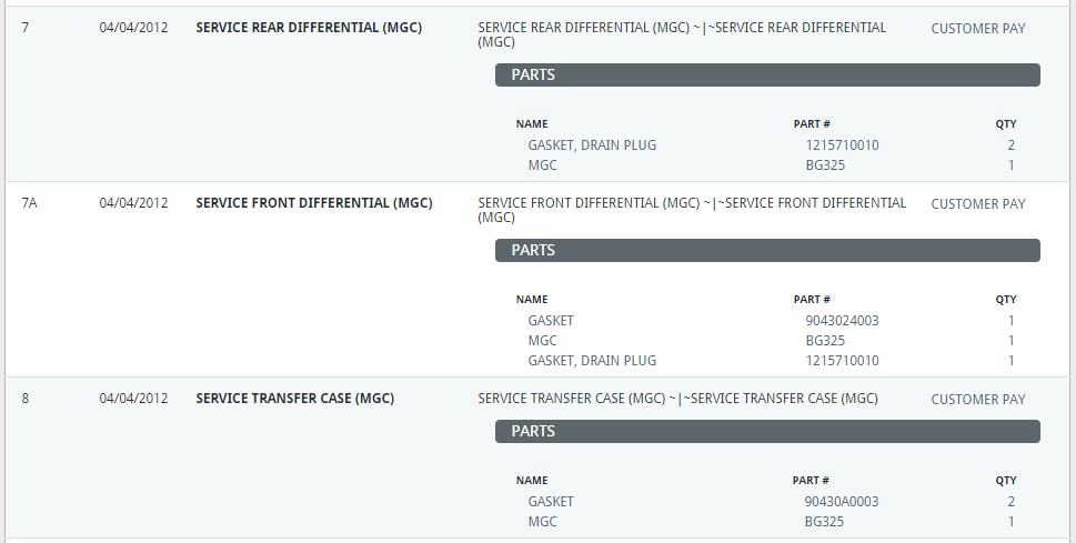

Looking through the service records for my 4runner, I found this:
It looks like when they did the diff and transfer case service they just opened it up and added some BG Multi Gear Concentrate. If they replaced the gear oil it would show up as a part, right? Bulk oil shows up under the oil changes.
When I asked the service writer about it, he told me "that's good stuff". He wouldn't elaborate on whether they changed the gear oil, but I was frustrated with the whole trip to the dealer, so I didn't push it. I later learned that they get kickbacks from BG to sell this stuff to consumers.

The crush washers match the parts in http://www.toyota-4runner.org/maint...ntial-transfer-case-fluids-pics-included.html except the transfer case number, which is different.
I'm trying to figure out if the gear oil was ever changed, or if it would be a waste to do it soon? I'm at 82,000 miles now, and this service was done at 61,000 miles. If they really changed it, it isn't be that old. MGC doesn't look inherently bad, but if it was good wouldn't oil manufacturers include that stuff from the factory? I'm leaning towards just changing it all since I don't know what's in there, and I will probably never have to do it again.

A similar service was done at 35,000 miles, but only one gasket was used for each. That strongly suggests they didn't drain it and refill.

depends how the parts guys bill it out and if they bill it to service or bill it to the tag. It also depends how that dealership bills out their oils, some dont bill on the tags for shop oil. Only if they get it out of parts stock. It very well could be they didnt change the fluid and just added their kick back concentrate. But it could also just have been billed differently.
And all service writers get kickbacks, so do most techs. Dealerships dont screw people, negligent people screw themselves. Its a business remember.

I was hoping I could figure out for sure if the fluid was changed, but it sounds like the way it's billed is inconsistent, so this might be a normal service or a "special" service that just adds the magic additive without changing the fluid. It seems like a waste to change it again after just 20-30,000 miles if the oil was changed, but I don't know what's in there and I'll probably never have to do it again.
