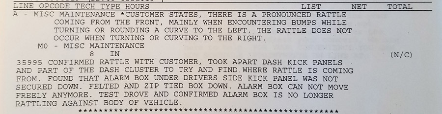

Not only that - I was at the dealership the other day get an annoying rattle fixed that's been driving me crazy for the last year or so. Turns out the rattle was caused by this aftermarket KARR alarm that they'd put in. Even though I didn't purchase the alarm, they left the various components in the 4Runner when I bought it. Apparently, this crap isn't worth the effort for them to remove it when one declines buying it.
Below is my description of the rattle and their fix as noted on the repair order.
If that piece of crap was installed by that dealer, then I'd call Toyota corporate, complain and demand that a different Toyota dealer remove said piece of crap and replace all affected wiring harnesses.
