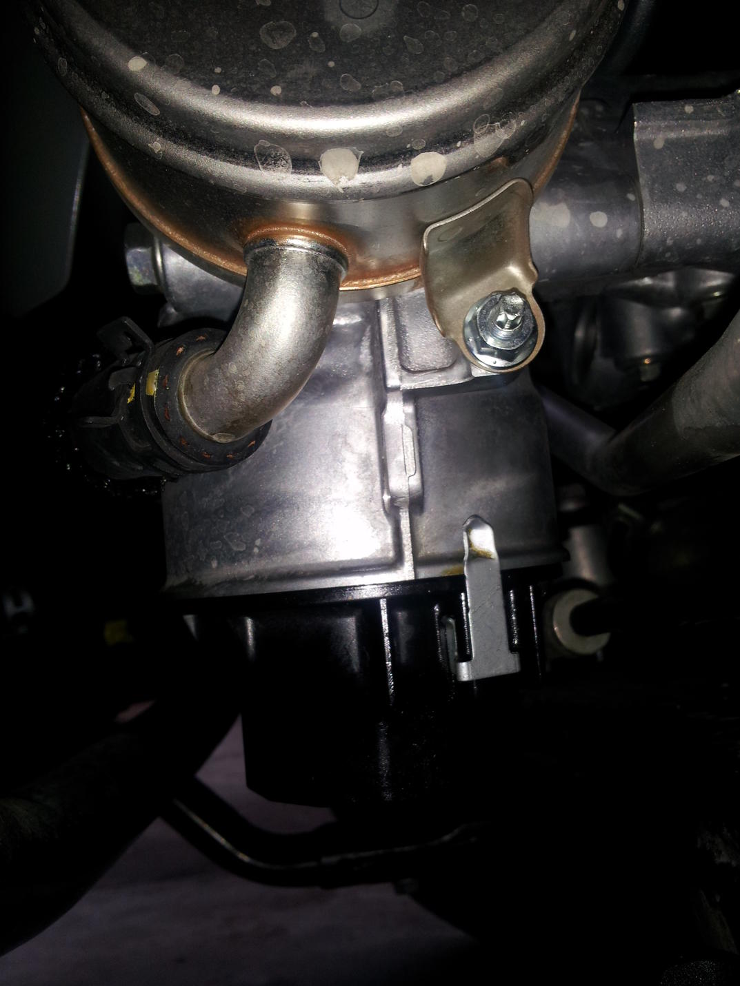

10K ToyotaCare service done on wifes 2014 4Runner SR5 this past Wed. Checked torque on lug nuts when I got home. 2-3 lugs where way looser on each wheel. Not falling-off loose, but noticably looser than the ones that were snug. Broke out the torque wrench - looked up proper ft. lb. setting in owners manual and got after it.
Oil appeared to have been changed and level was OK.
Was curious about the filter buried below. Pulled the 2 undercovers(one plastic/one metal) and it appeared they changed the filter as the filter housing index tab was in my opinion too far past the associated index mark above. I changed the oil/filter at 5K myself because that's what I do. I had the index marks lined up after the 5K oil/filter change.
I backed it off to where it should be knowing that time in that spot could make loosening later even harder. Idled engine 'til warm - no leaks. I used a special tool used for this - PBT 71113 and was surprised at how much elbow grease I had to use to get the oil filter housing positioned back to where it should be. A person can get carried away with over-torqueing this plastic oil filter housing.
Attached a photo of the oil filter housings position after returning from the dealership. Would appreciate a dealer techs opinion of this. Am I being too anal with regard to the oil filter housings position?
And please....no comments like "you should have taken it back.....". 60+ miles to and from on a highway that's being reworked - countless construction delays, not to mention even more time lost once back at dealership. I got it straightened out PDQ. Will contact the dealerships service mgr. about the lugs once I have a professional opinion about the oil filter housings position.

What's the 'associated index mark' that you mention? Mine has always ended up about where the one in your picture shows.

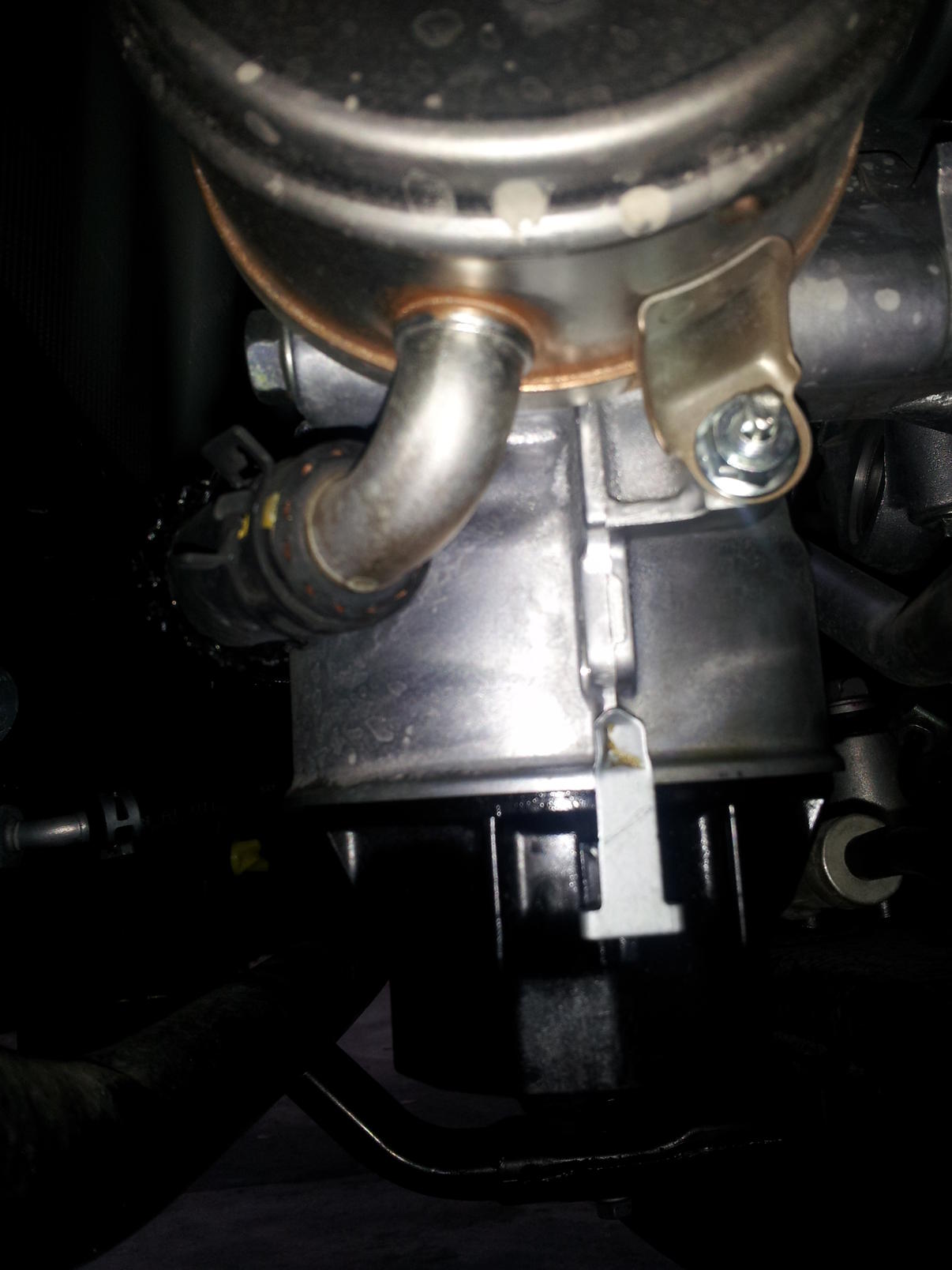

Maybe not the best choice of words. Here's a photo that shows how it should be set.

I'll admit that I've never used a torque wrench to tighten the housing. But mine has always reached kind of a 'stop' where your original photo shows. The type of feeling where another 50 lb-ft wouldn't move it much if at all.
I've never liked installing that housing. It feels weird pushing that o ring up into the body as you run up the threads. But I've also never had any difficulty removing the housing either. Nor have I had any leaks. So I guess what I'm doing seems to be solid.

Oil filter housing "torque" is simply a matter of lining up things like you see in the 2nd photo.

That's not an indexing mark really, its just a casting left-over. The Tab is just so it doesn't back off completely by itself.
That being said a of people do over tighten them, I like to just snug them with a ratchet and even then they can be tight to get off with heat cycling.

Thanks for the response. The first time I changed oil - 5K - mine was set the way you see in the 2nd photo of this thread - tab lined up with casting left-over. I believe I saw the same thing on page 2 of Antmans oil change how-to.
What I do know is the position it was in(1st photo of 1st post) was way too tight in my opinion. Took an unusual amount of pull with a breaker bar to pull it back. Seems like "any tighter" and things could have gotten weird.
I'm going to use tab-aligned-with-casting-left-over as my bar. Again, that's how it came from the factory.
Not really true. If you want to do it by the book, Toyota FSM calls out a torque of 25 N·m {255 kgf·cm, 18ft·lbf} for the filter housing. BlackWorksInc is spot on.
IMHO, you're worrying about it way too much and should be grateful the clip wasn't broken off or intentionally discarded by the tech (seems to be common practice with this style filter!).

Nothing wrong with that, I usually get it seated so its flush against the oil filter pedestal and then turn it 1/4-1/3 of a turn after until its "snug." I almost never have to do more than "bump" the handle of my ratchet to get them off. Some of them are so damn tight I literally need to tap the oil filter with a 1/2" impact to loosen it or use 1/2" breaker bar with a cheater on it!
Thanks for the torque spec. I'll see where things land when I change the filter at 15K using 18 Ft. Lbs.

Lester my friend I hate to tell you this but you can't use a fixed point to index a single part threaded connection, especially one with dissimilar materials. Over time, threads will change due to fatigue, material type, temperature and just plain stretch. Also the manufacturing process would dictate where the correct point was and it would be different for every vehicle. If you used a jam nut for the connection then yes, it could be done.
Now, you might pick a point and it will be the same for years. You might pick a point and it will be different the next time you change the oil.
Same goes for counting threads in order to make the correct adjustment for something. It will get you in the right town but not even close to the right house.
OK - in review:
5K - 25K tire rotation - ToyotaCare:
Check to ensure that there is at least uniformity in the lug tension. Mine were all over the place. I will continue to "torque" check.
5th Gen Oil Filter Housing:
I(and others) apparently misunderstood the relationship of the "index" tab on the plastic housing and the over-casting. However, I will continue to use it as a guide as the 2 were in align at 1st 5K oil change and follow the torque spec provided above for the plastic housing. [MENTION=66316]1engineer[/MENTION]s comments about material disparity taken into consideration.
