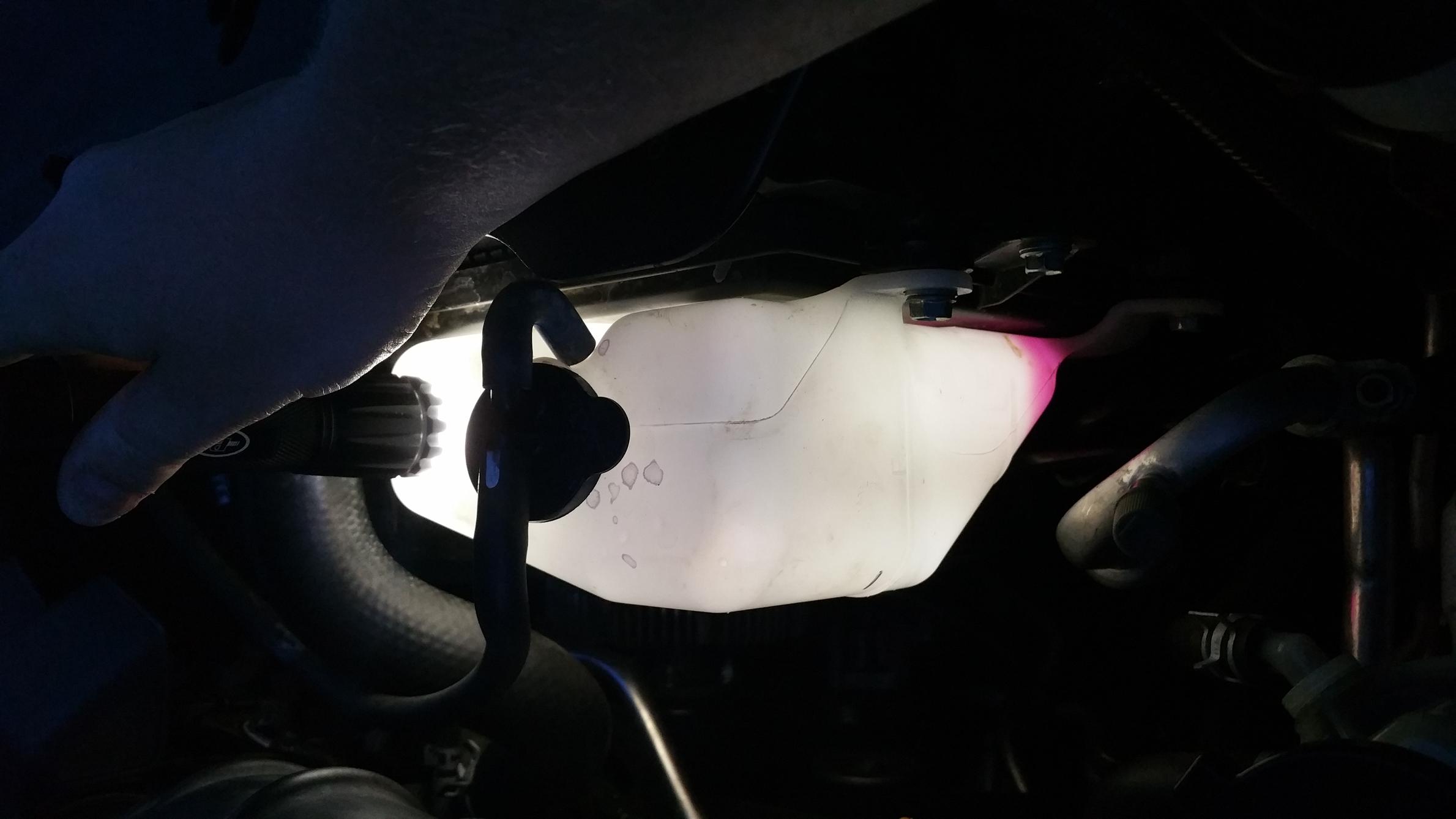

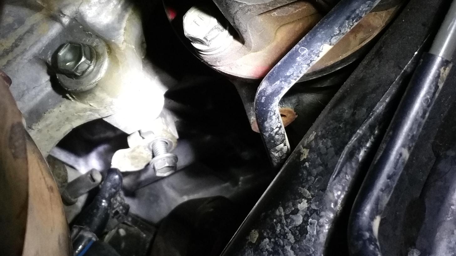

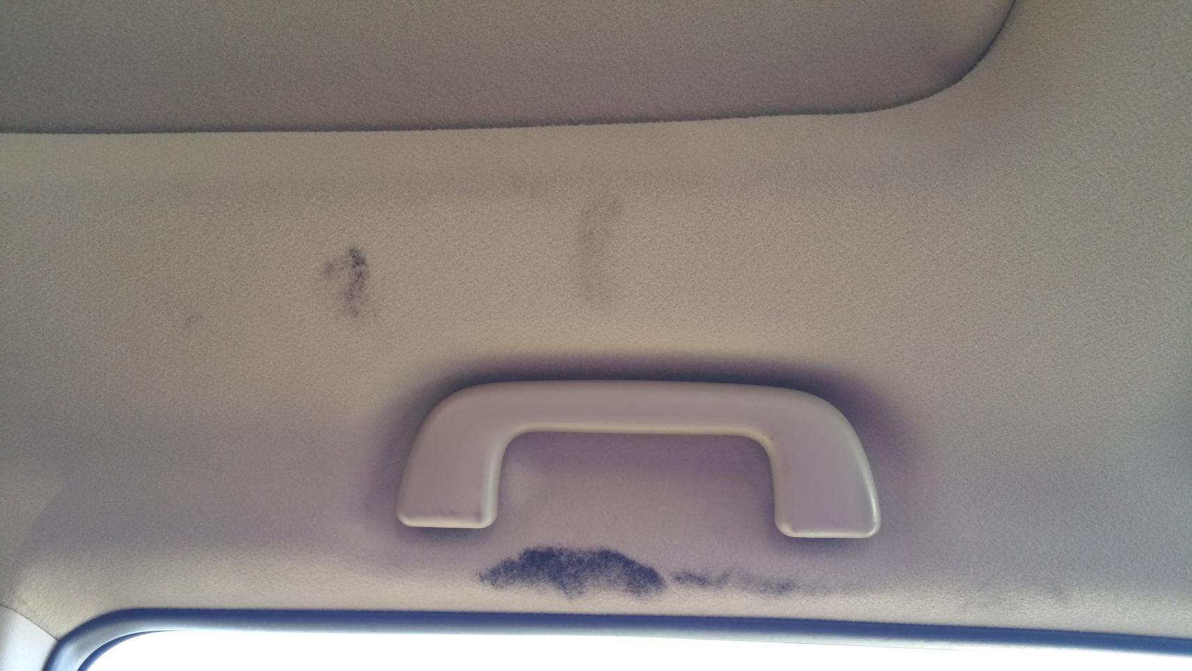

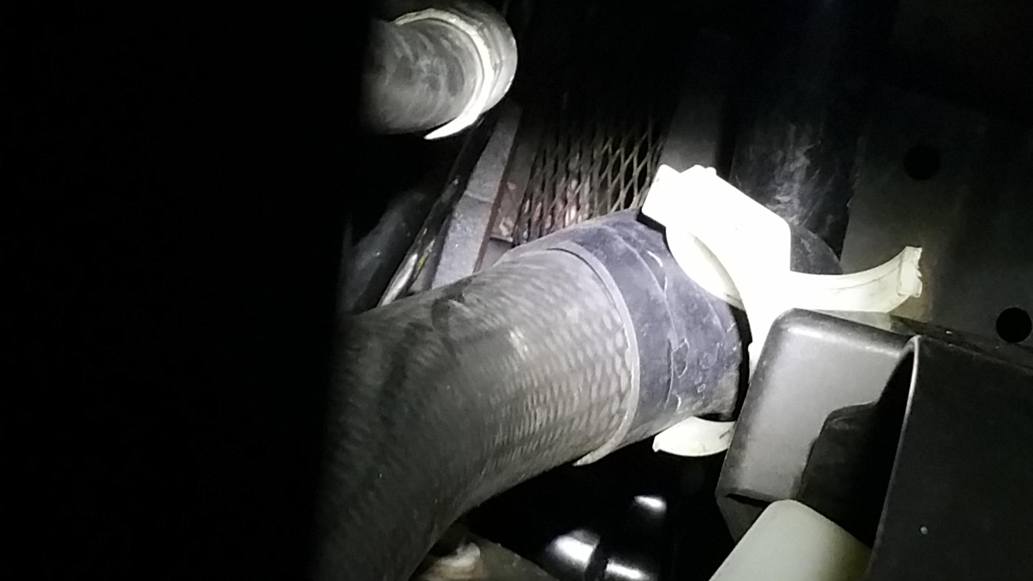

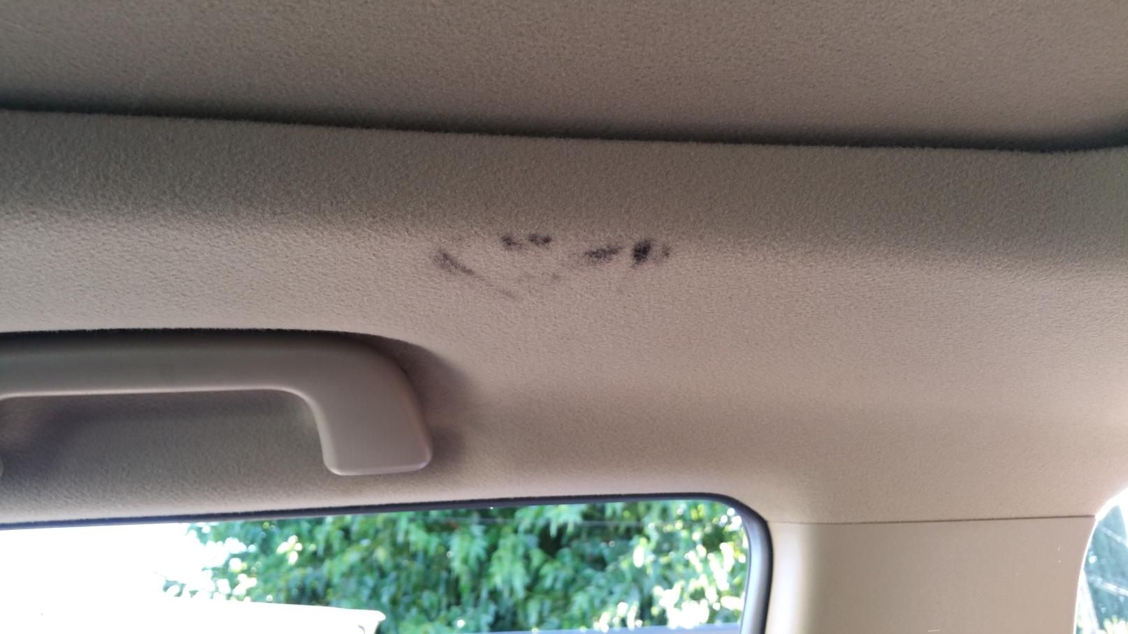

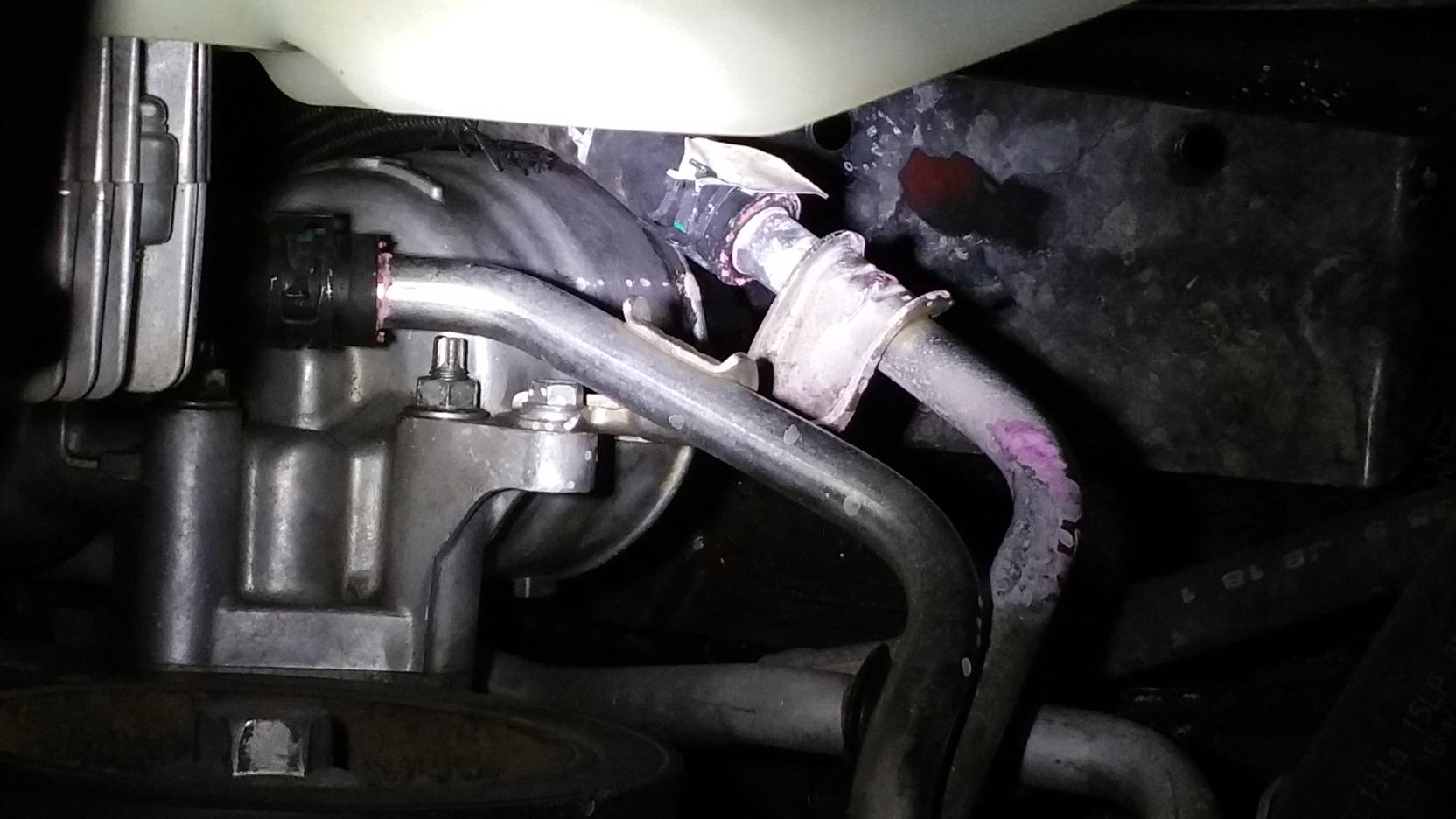

I've had my 2010 4Runner with 50k to 3 different dealers and not happy with any of the repair service I've received. The main issue was a couple days after I got it it started smoking. The GMC dealer I got it from had to take it to toyota for "new valve guides". Not the problem. 2 months later I finally get it back with a new motor and this is how I got it back.
Grease on the headliner in 3 different spots.
Leaking coolant because they reused hose clamps
Multiple little things
Didn't tighten the ground bolt for the starter, left me stranded.
