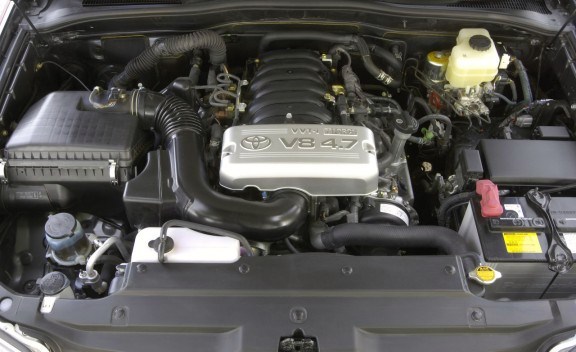

your dipstick will tell you what fluid it takes in 07 they started turning most yotas into ws like 08 tc has dipstick but takes ws..
if your really that concerned about the fluid just take one of the hard lines off the rack and fill it up. toyotas really dont have issues with steering racks.. unless its a hybrid highlander
Well, you have a '99 model (3d gen). I have the '03 model (4th gen).
I also have an 04 in my sig :whip2:
this picture is showing when the bottle is empty, with no fluid. that's for a 4.0 V6, exact same bottle as your V8.
best way to check it is to read the cap. the center of the cap says "power steering fluid", but the smaller print below it you should see "Dexron ATF"
I could be wrong on this, but if your V6 tranny has a dipstick, then it uses Toyota T-IV.
WS is only used in sealed transmissions.
