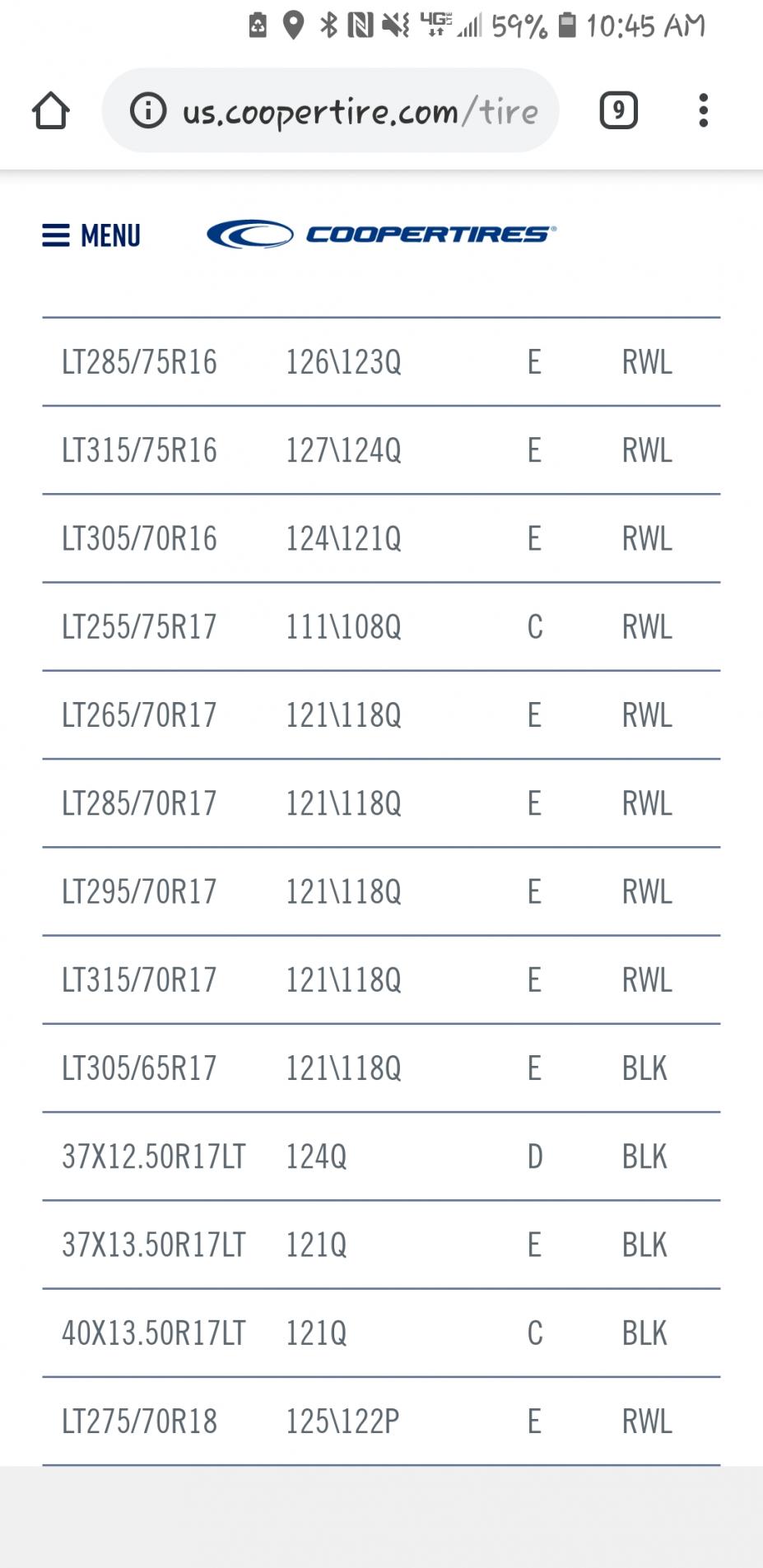

What corn fed spacer lift are you running to fit 305/70's? Did you have to regear? BMC and mods needed? I dont see that size listed on the cooper website.... are they the 305/65? Intrested in your setup, looks great.

Not this ^
Anytime someone starts their recommendation with “save your money” and “spacers” you should cringe and ignore.....spend the couple hundred more and get springs. The drive quality and off road performance difference is night and day.
