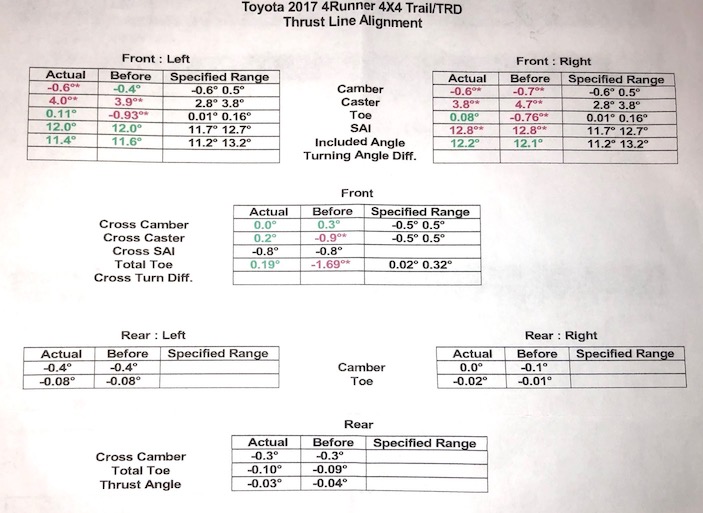

Added the UCAs over Father's Day weekend. Alignment of caster now at 4.0/3.8 everything else is in spec.

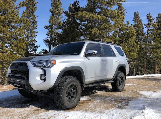

The photo is out of date. It was taken last spring before I changed the tires to 285s.

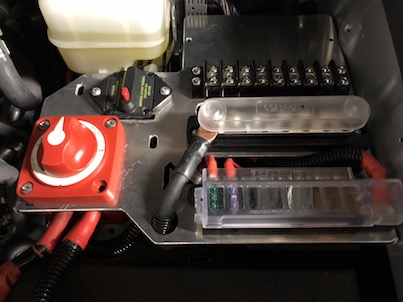

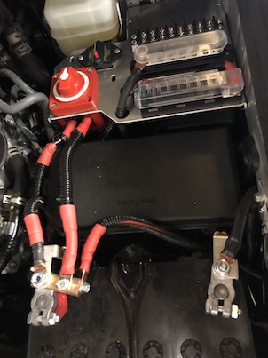

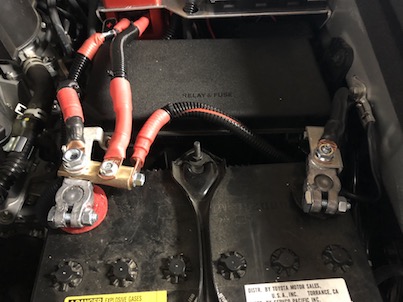

I've never understood the idea behind having a winch hooked up to the battery at all times. After a lot of research on quick disconnects and shut offs I finally decided to use a BlueSeas on off switch. But then I had to figure out how to cleanly mount it. After some bad L bracket ideas, I finally decided to pony up for a PowerTray on the hopes that I could customize it.
With the help of a dremel and a drill press I took a PowerTray made for a SwitchPro and cut two holes in the inner side of the tray so that I can fit a BlueSeas On/Off switch for the winch and a breaker for the rest of the electronics.
Honestly it was more of a pain in the ass to install the plate than it was to customize it.
Here's the final product.

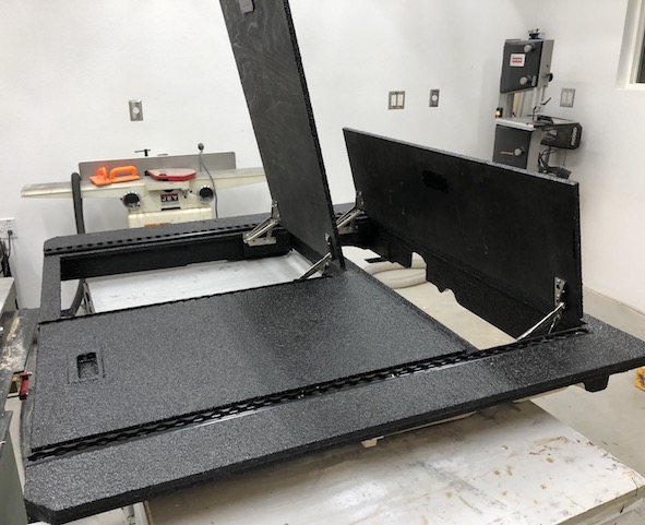

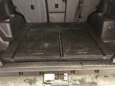

My inspiration came from Dieck's post. Toyota 4Runner Forum - Largest 4Runner Forum - View Single Post - "Base Camp" 2015 Superwhite TE Build Thread
My design is slightly different in that I took the section right behind the seats into a single piece that stretches the width of the vehicle and I went a different route in attaching it to the vehicle by using L brackets the threaded inserts right behind the seats and just bolts at the rear of the car. I built it so it sits really snug between the wheel wells anyway so I'm confident it will stay in place.
All in it took me about 6 months to do it but I could probably knock one out in a long weekend if i worked on it continuously.
I do regret using Hefty bed liner b/c it smells really bad. I let it sit outside for over a month before installing it and it still smells. I'm pretty disappointed in that part of it.

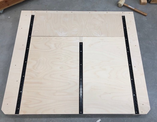

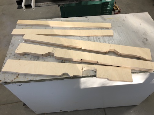

I started by using MDF to make templates for the rails and styles. Then with band saw and router I cut the actual rails and styles out of baltic birch ply (IMG_4286).
Next is the glue up of two 3/4" pieces per rail and just using a single 3/4" piece for the styles. (IMG_4287)

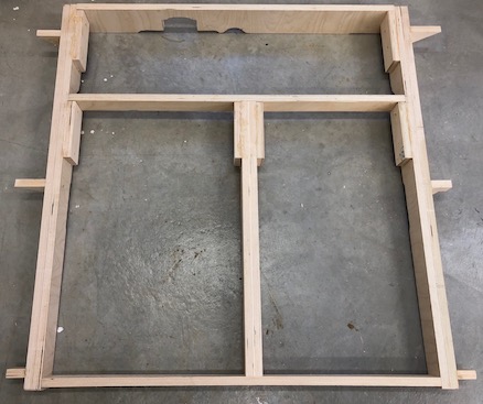

Test fit of the assembled rails and styles (IMG_4288) as you can see on the style next to the seat I had to do a lot of cutting to get it to fit as close to the seat as possible.

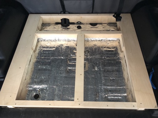

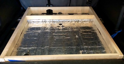

Then I put the center rail, hinge blocks, and side support wings on (IMG_4306) before starting to layer up the non door parts of the top (IMG_4309)
Then I cut and test fit the doors and the T track. (IMG_4312)
Next was the roll on bed liner (MISTAKE!) (IMG_4445)
And finally the finished product. (IMG_4459)

It's been 3 months since I finished the rear storage and the smell is nearly gone. We'll see how it does when it starts to get hot out side and the truck bakes in the sun for a while but for now I'm happy.
One issue I'm having is that the lids bounce a bit. I've already put some sound deadening on the insider of the lids but I think I need to latch them.
Was going to go this route unless someone has another suggestion.

Nice. How did you secure the platform to the cargo area?
Thanks! I was really happy with how it turned out and how perfectly I got the dimensions.
I used the bolts for the existing D ring mounts right behind the rear seat with L brackets attached to the back style of the storage. at the rear door I used L brackets and lag screws. I may replace the lags with bolts at a later time but right now it's secure. I've yanked on it really hard and it's solid.

Edit: Alignment of caster now at 4.0/3.8 everything else is in spec.

What kind of hinges did you use?
