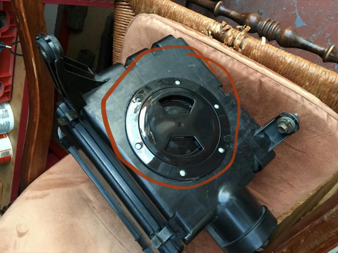

Jaysen4runner New member Mar 24, 2017 #1 I been shopping around and can't find this deck mod part. I can't find it anywhere, that the part name? any help guys Attachments 2017-03-23 20.28.58.jpg 116.7 KB · Views: 241

JerkyDrewster Member Mar 24, 2017 #2 Jaysen4runner said: I been shopping around and can't find this deck mod part. I can't find it anywhere, that the part name? any help guys Click to expand... It's a deck plate for a boat. You can just search google for that and should find it pretty quick.

Renegade_Medic New member Mar 24, 2017 #3 Also known as an inspection hatch. Try Academy Sports, or any marine/boat place. You don't want to go much over 5" Diameter. Most seem to use a 4" Either will work fine, they are both exponentially larger than the intake.

gamefreakgc Elite Member Mar 24, 2017 #4 Yeah, I bought mine from a marine supply store. 4" I think, that's the size of the opening and you need another 1" or so for the other piece to fit.

the walrus New member Mar 24, 2017 #5 This is the one I used. A 4.5 inch hole saw makes quick work of cutting the hole. https://www.amazon.com/gp/product/B004RCWXIY/ref=oh_aui_detailpage_o01_s00?ie=UTF8&psc=1 .
