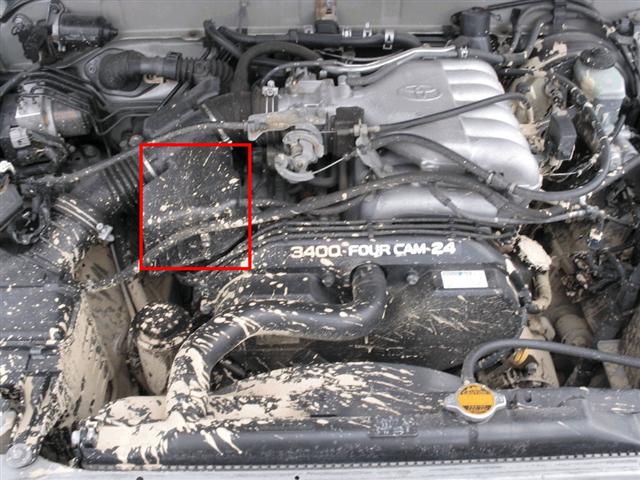

ok thats what im looking for a nice hum. also is that a 2nd air box? the smaller one next to the big one? someone asked me about it and i just told them it was for when the ect power was on, it would take more through there?
your MAF? a pic would help

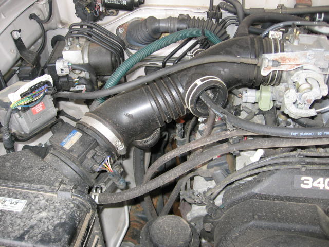

I think you're looking at one of the 3 silencer boxes. Here's a picture of my engine without them. I removed them and bumped my horsies a little in doing so. It's simply a little box that helps quiet the air intake stream, as well as the exhaust tone in doing so. By removing them, I gave the air intake a less turbulent pathway, subsequently improving horsepower; the same way a cold air intake works.

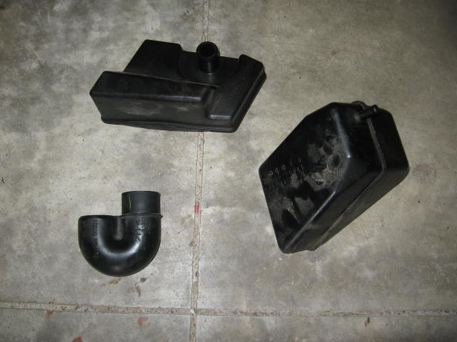

Here's a pic of the three boxes removed. They've been replaced with ABS end caps.
