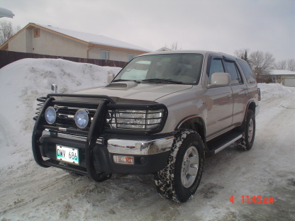

Im pretty curious about the deck plate mod, i want to do it with my 99 4runner but what are the pros and cons about it?
