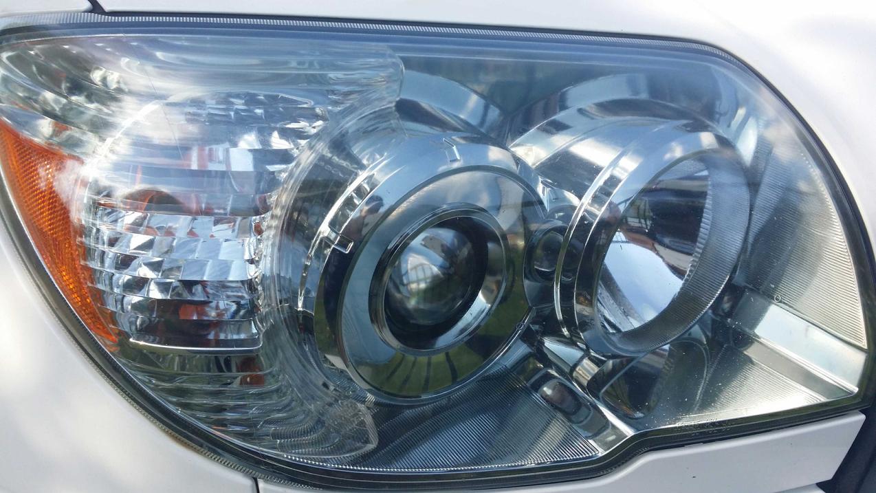

Saw a clip about using deep woods off to restore headlights....my 2006 were getting a little cloudy....long story short the stuff works...wish I had a before shot...hope the pics work via tapatalk

A bug repellant???!! Wow, saw some videos of this. Now I never want to use it as repellant...... But seriously, I would STILL use some sort of protection AFTER you restore them.
Yup bug repellent....just a little bit and no scrubbing...it took like a minute. Now mine were not very bad just a little cloudy but it works....unreal..and yea...think Ill just live with the bugs from now on

Will this last though? Or is it just the oily properties of it filling in the cloudiness?
Deet does work. The problem like any other cleaner for plastic head lights is that the plastic will just oxidize again in time. you have to seal the plastic somehow (search around the web for this) to get long lasting results.

Ha! My dad just did this to his F250 last weekend and I thought he was nuts. Worked surprisingly well. It's like it "melted" the oxidation right off.

I did the OFF today. Very psychologically satisfying because the rag or napkin you apply it with really turns yellow/orange.
Anyway on a scale of 1 to 10 with 10 being new headlights... Mine were a 5 before treatment and 7 after. After the Deet, I soaped 'em up then used glass cleaner and applied a couple coats of RainX.
Funny thing was that the fresh rag used to apply the RainX also picked up a lot of yellow stain off the lens. Even after all that cleaning.
