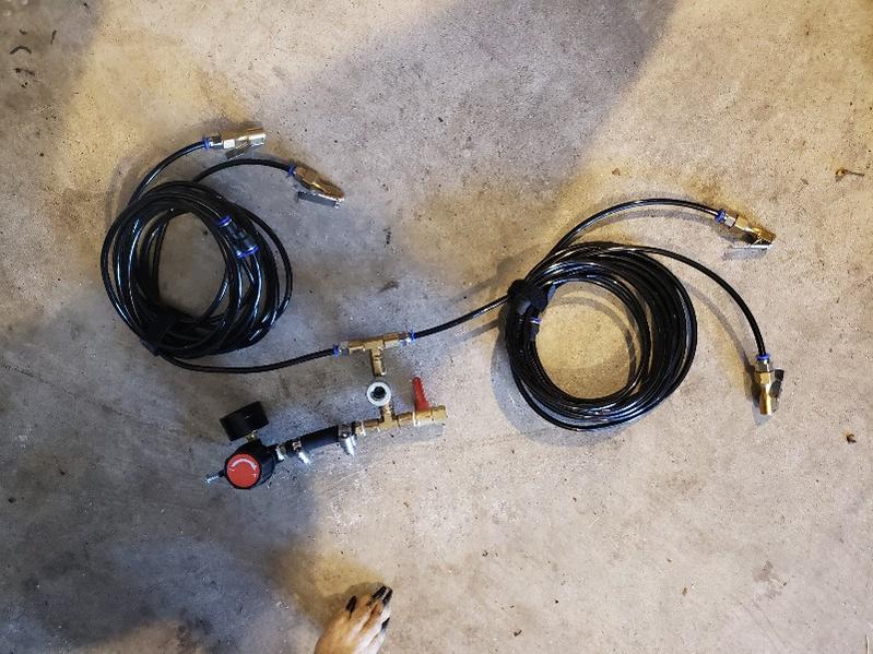

I made my own :) . This is Version 2.0 that I clearly cobbled together.
To deflate, I hook up all for tires, then use the release valve to deflate them tires at the same time, to the same pressure. It takes about 10 seconds per 5 PSI, and I just stop periodically to check the gauge on the regulator. I initially thought I could leave the regulator set to a specific PSI and it would auto-deflate, but the release rate is so slow it took like 40 mins to actually deflate the tires from 40 to 15 PSI, heh.
To inflate, I hook the coupler to one affixed to my rear bumper that comes from my pump. However, because I used a regulator valve on the inflator/deflator, I can keep my pump's line pressure at 90+ PSI, and the valve on my inflator / deflator simply starts to hiss when I reach target pressure. It takes 9.5 minutes to go from 15 to 40 PSI, and they are all at the exact same pressure.

Haha feel free! I have far less time than money these days so if you want to take the time to put a few of these together, have at it! I think it would have cost me something like $50-60 to make, but you could probanly get those costs down with a bulk order.
I used the following supplies, purchased from mostly ebay
--6mm Pneumatic tube (about 40ft I think).
--6x 1/4 NPT Male to 6mm Push Connector
----(2 on the inputs, and one for each tire).
--2x 6mm Push Connection Y fitting
--4x Closed locking shrader connections
--Basic inline regulator from Harbor Freight. (Hook the outlet side to the tire system, and plug the inlet side).
--Version 2.1 will replace all the brass T-fittings with a 5-way brass block so dramatically decrease the size of the object. There is one on Amazon for like $12.
