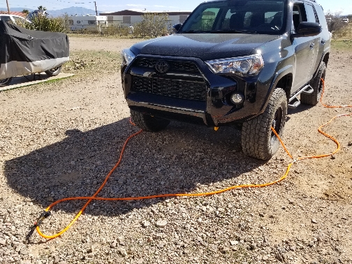

I made one also. It deflates (inflates) all 4 tires at once to exactly the same psi.
30 psi to 15 psi in about 2 minutes. Back to 35 psi in about the same with the home shop compressor. (had to go to 35 to turn off the TPMS light, then back down to 30)
Cost with 100' hose (only used 50') was around $50-60.
