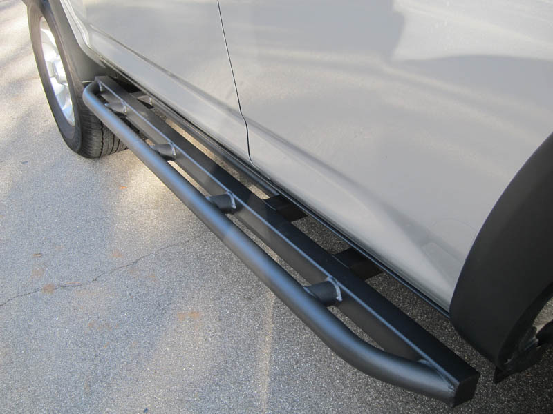

Now installed by Demello (so they're definitely making, selling, installing them):

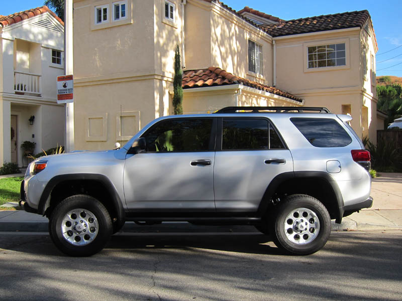

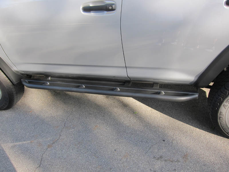

These are the Demello Sliders I ordered around the first of the year. Pics are pre-OME lift.
Really like the design, and very well made. The mesh on the kickout is a perfect rear step.
Since each was a build to order, I did have them pull the sliders in by 1" so they tucked a little more under the running boards than other 4Runner versions they offered.
