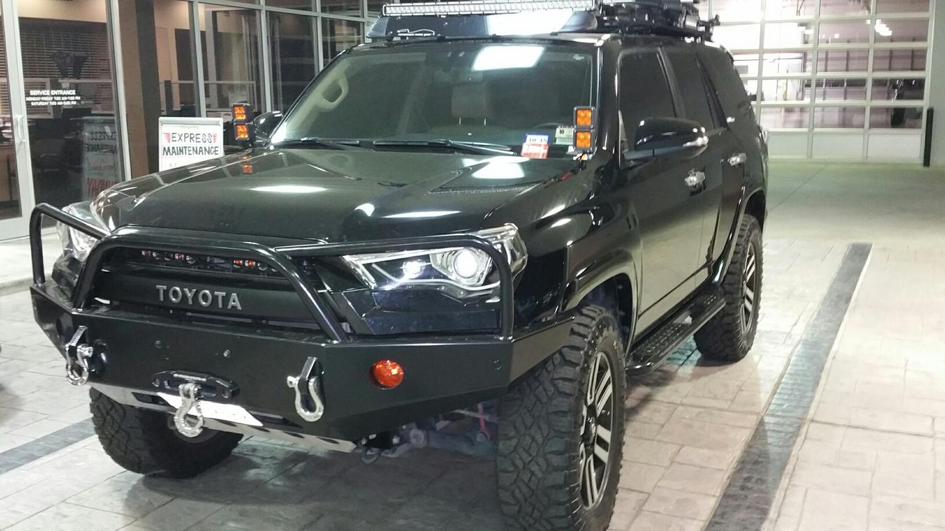

I like Jason personally and he has pretty cool stuff. I was at the Lone Star Jambo and saw his Demello 4Runner. I was sure then that I made the right choice with my SW bumper and the TRD Pro badging

I love my arbs hate the fit even on my FJ sticks out way to much
have to say nice looking bumper as it fits without sticking out a mile :)
but has nice classic lines
