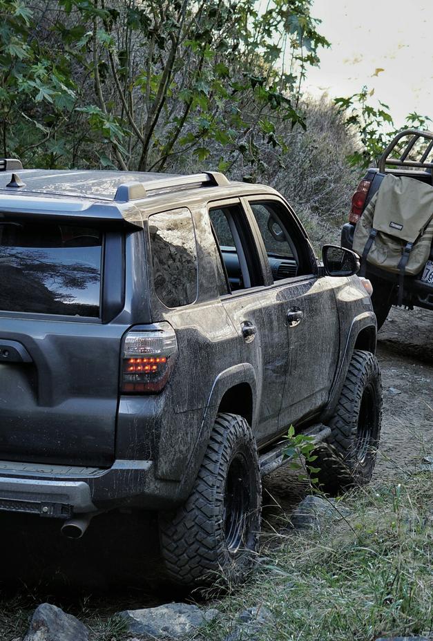

Looking for any feedback on these from those who have them. I need some form of a step for to help the kids to get in and out and also for my short wife. Just wondering if these can be used as a step of sorts or is it strictly just a slider. Thanks
My brother has them on his 2014 4Runner TE. They can definitely work as a step. They come out past the door a good couple inches so they work perfect as a step and even better as a slider.
[MENTION=73139]N2GLOCK[/MENTION]
You can definitely use them as a step. Here's mine.

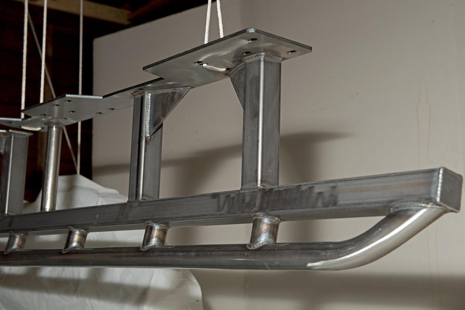

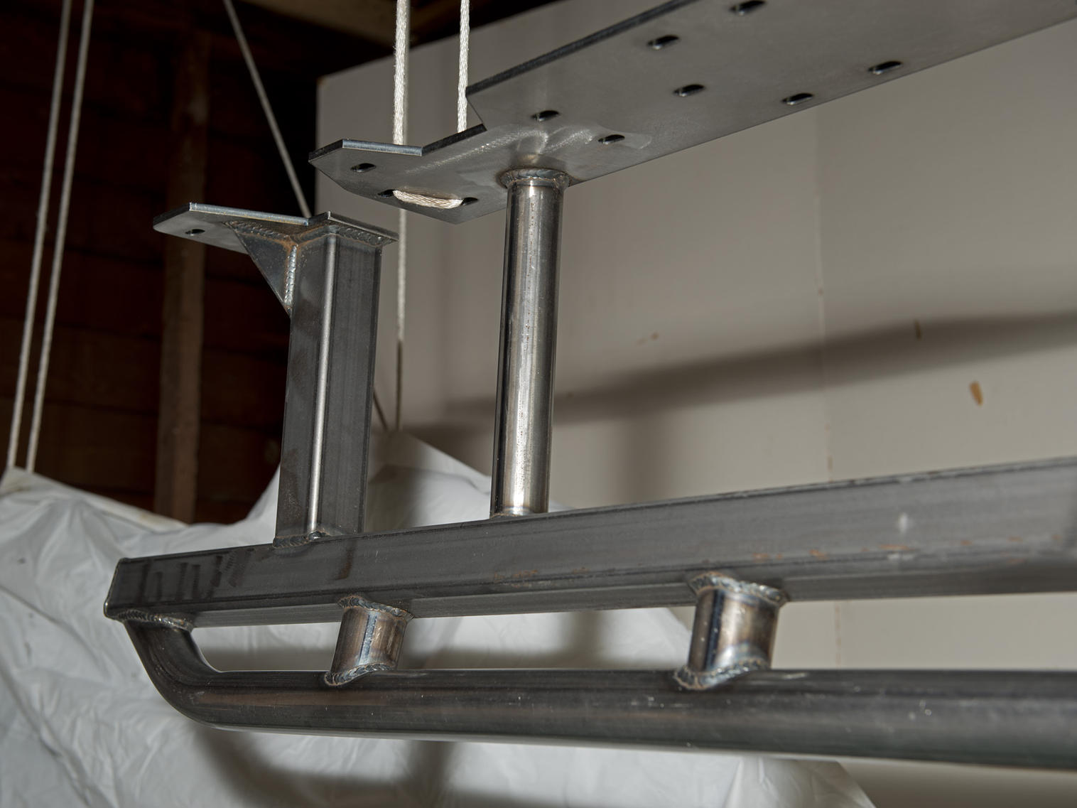

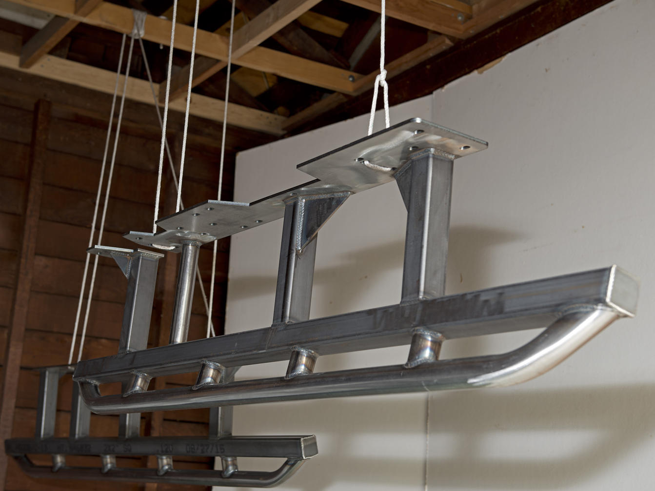

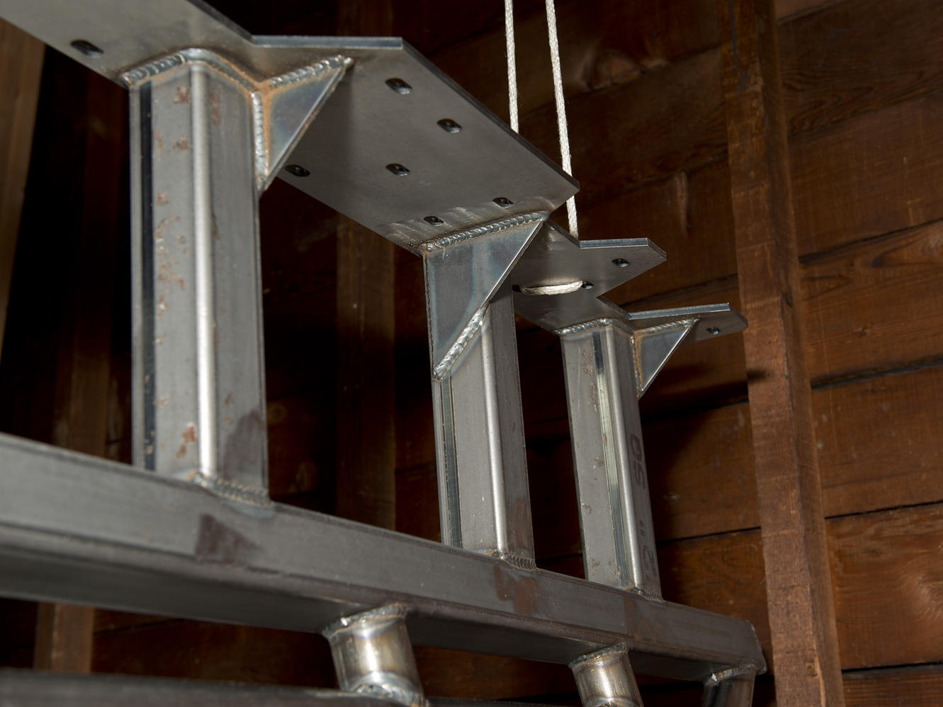

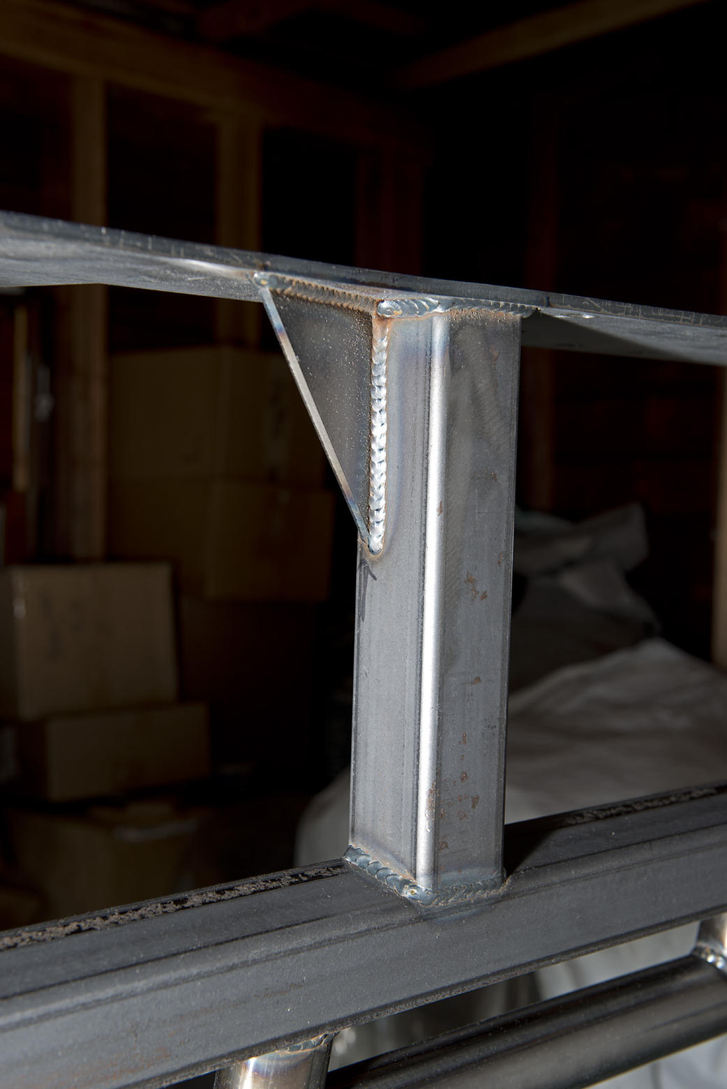

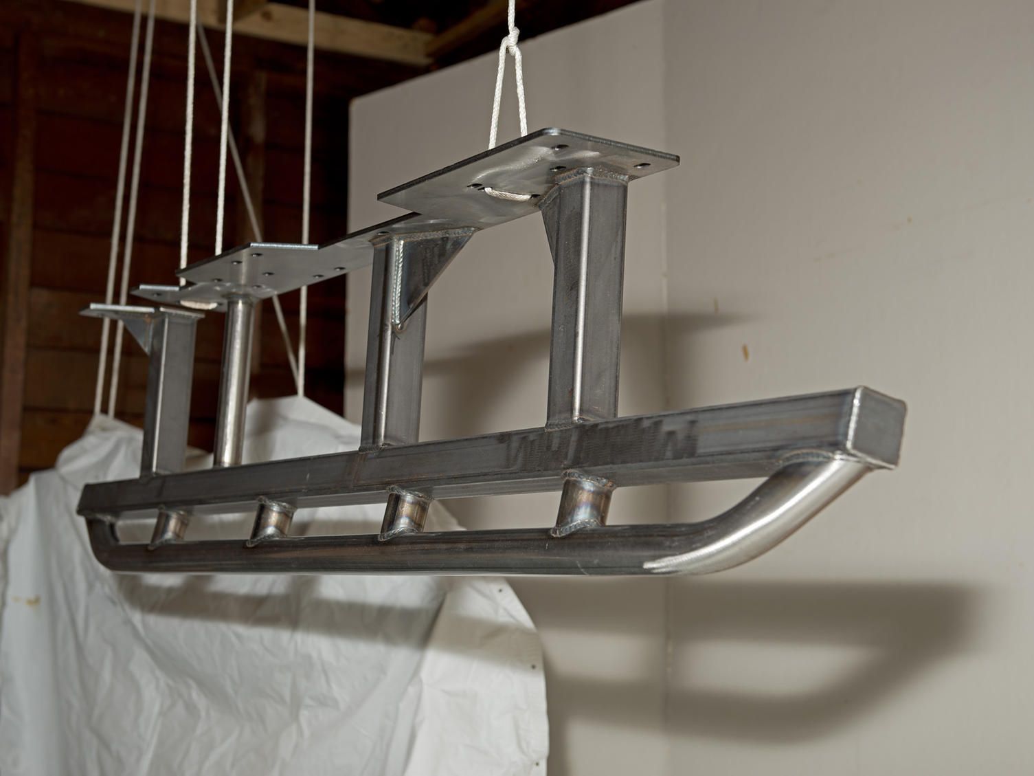

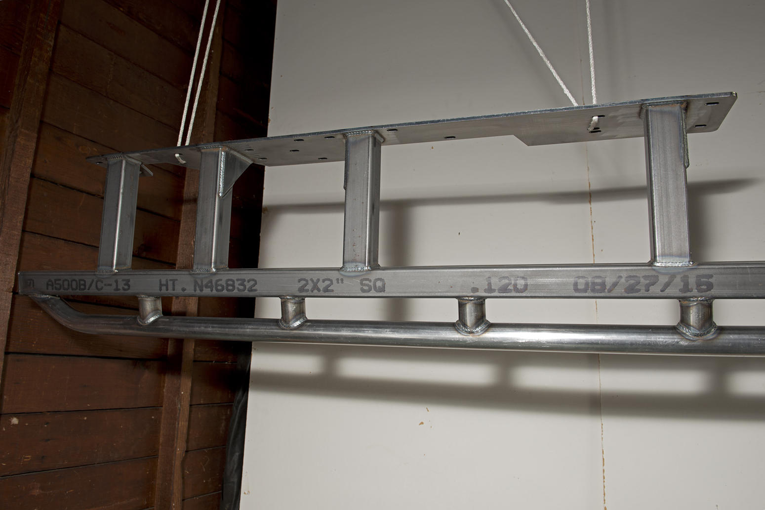

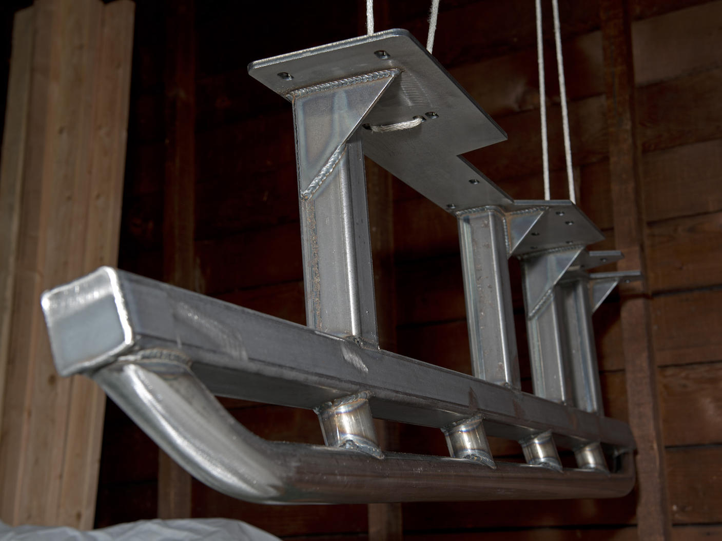

Bought them bare steel, thinking I might want to add gussets. They are really stout so no more gussets are needed.
And I thought I could save money painting them myself. Not so. It took me an hour or more to clean the cutting oil and normal shop grime off with mineral spirits (we can't get paint thinner nor oil based paints in Los Angeles County since a couple of years ago). The first coat of Rustoleum primer took 2&1/2 hours to apply with a brush. The paint was old and full of dried paint flecks. Now I have to sand them off before the next coat. I plan to apply 2 coats of primer and two coats of black enamel by brush and two coats of grey by spray can, all Rustoleum products.
But back to the question about KDSS. They started building them differently than what they show on the website to fit the KDSS. They don't show the KDSS, driver's side very well on the website. Only the passenger side. I'm taking photos of mine that they might be able to use to update their website.
Here are some photos of the sliders hanging in my garage before painting. First, the driver's side with accommodations for the KDSS, including one round tube strut and gusset plates angled down to allow clearance for the KDSS lines. The mounting plate has one opening. The passenger side is more like what's shown on the website but with one continuous mounting plate instead of individual plates. All of the gussets extend up to resist bending of the struts at the mounting plate.
Hopefully all the photos will line up in the same order I uploaded them. I tried uploading them from my SmugMug gallery but there's no cut and paste function here. https://whaleshark.smugmug.com/photos/swfpopup.mg?AlbumKey=V2MDMC
They told me they would make all of their sliders for the 4Runner the same whether it has KDSS or not. They didn't have instructions written for them yet but Daniel said just to lift it up and slide it left to get it into position.

They fit just fine with KDSS. You just remove the skids and a couple bolts holding the KDSS lines in place. Once the driver's side is installed put the lines and skids back on. I did cut out 1/4" on the skid plate under the frame that protects the lines just to give it a little clearance. I sprayed mine with bedliner paint. It has a little sparkle in the black for a different look and has held up very well so far.
