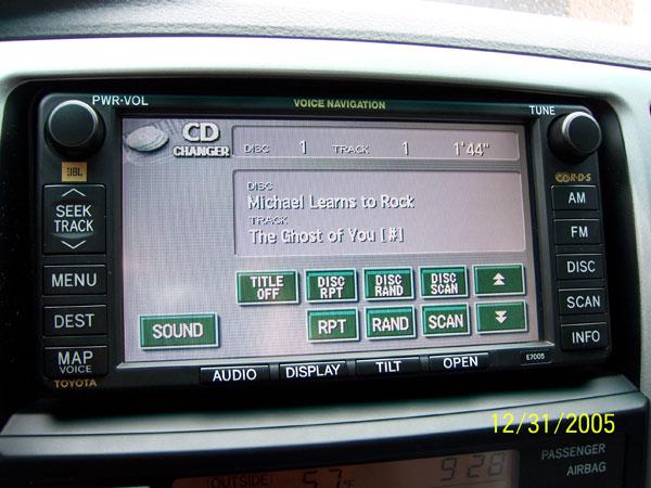

Yes the Dension does display text, but apparently there is a bug that it only shows the first song's title.
I have the 2005 JBL single disc CD, and it displays and changes the song title 75% of the time. It sometimes doesn't change, but I can force it to update by toggling the random/shuffle button.
It's the artist name (shown as the disc name) that doesn't change for me. That is what remains set to the first song played. Toggling random/shuffle doesn't get it to update, but switching to FM/AM/CD and back to CD1 seems to.

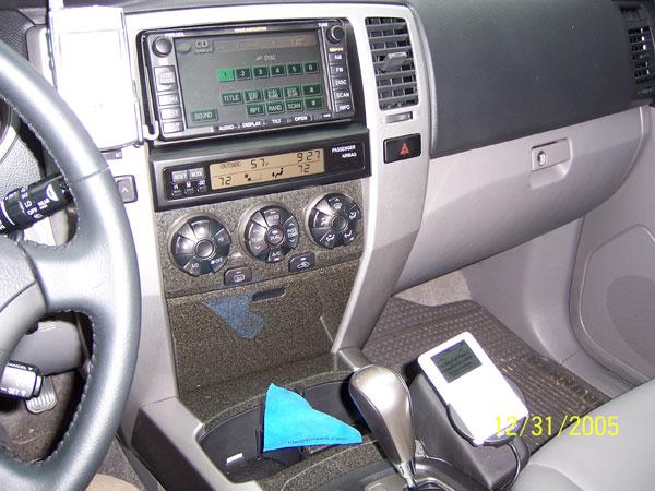

Thanks j0mama for the Dension .... installed it in 1 hours and it works .... it just sometimes the Disc Title / Artist display is mess up ... other than that it great...
now i need to get rid the iTrip LCD (for sale for $30 shipped) and my cheap FM Transmitter (FREE, just pay s/h)
1
^^^^^ Dension Dock with KUDA Mounting ^^^^^
^^^^^ how can i make the repeat mode OFF for default setting ^^^^^
^^^^^ Title messed up after i turn the car off and on again, it works again after i change the "Disc". Also, i can't change the track too fast otherwise the title messed up ^^^^^
today, the headunit FREEZE for some reason. i have to turn the car off.
So, for now i just use the iPod UI ... instead the NAV Control
