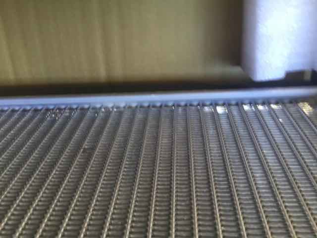

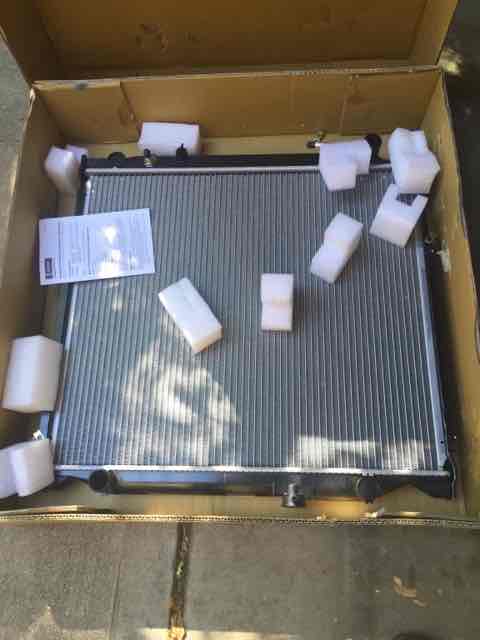

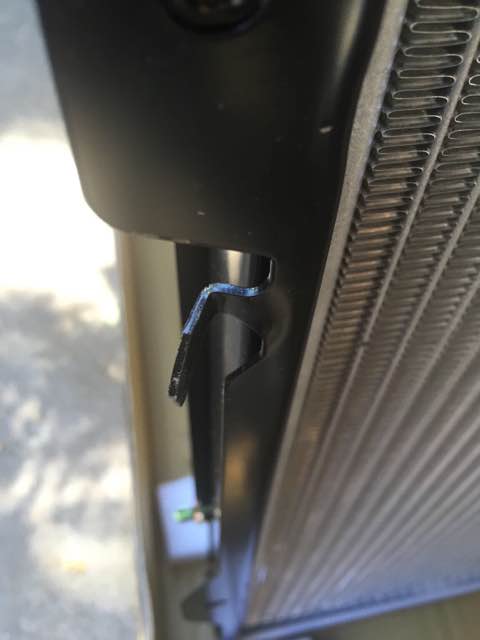

Hey all, so I naively believed that the negative reviews on Amazon for the Denso radiator and terrible packaging leading to shipping damage were old and outdated reviews. I mean, surely Amazon would start doing a better job of making their staff or vendors package these things better so they don't get damaged.
Well, I opened it up today all excited and ready to drop it in today and what did I find? ImageUploadedByTapatalk1443288491.176195.jpgImageUploadedByTapatalk1443288503.796969.jpgImageUploadedByTapatalk1443288522.156147.jpg
So, I know this isn't as bad as what other people have reported in the past.
Question is, do I let amazon send me a replacement and put this off for another weekend, or do I carefully bend the mounting tab back, and the fins if I can, and call it good?
It's still in way better shape than the one in my 4Runner now and a few bent fins shouldn't be a problem, right?
So, buyer beware on these...still. Just check it when it arrives and take care of it ASAP instead of waiting until the day you want to do the job.

Update: in Amazon's defense, they did just refund me for the whole thing within 10 minutes of my complaint. They didn't ask for pictures or for me to send it back. I guess I'll go ahead with the install, see if it can still work, and then buy a new one a little sooner down the road than I wanted?
Or should I still hold off and buy an undamaged one?
Since they refunded the money and let you keep it, I'd go ahead and install it. If you have problems with it, buy a new one. This one is free!
I'd inspect the end tanks very closely, but if they're ok I'd go ahead and install it. A few bent fins aren't going to hurt anything.

I use Amazon a LOT and they're generally really good, but this is one of those items they seem to have a hard time with. I think the issue is the factory packaging is intended more for bulk shipment to a retail outlet, and Amazon just isn't adding anything to it to withstand the abuse it gets on a delivery truck. I was going to buy one from Amazon and decided not to take the chance after reading the reviews. I think I paid about $10 more getting it locally.
Some are better than others, yes. But look at op's pics, 10 small pieces of foam blocks flying loose around the box. Are you kidding me??
What kind of protection does that offer for something that can be tweaked like and aluminum radiator?
So, I ended up installing it. I was able to bend everything back, and there aren't any leaks (so far).
