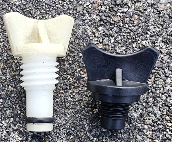

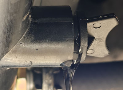

So here's my complaint. Why is the petcock half the size of the original and of such low quality. When I loosen it, it wobbles almost like the fitting is off. When I hand tighten it down I feel like it's going to break off in my hand. At one point I just stopped tightening and called it good.
The new radiator does not even have the weep hole below the petcock, where you could blast pressurized water straight down like you could with the stock radiator. You have to carefully loosen it so it starts trickling, and don't dare open it up too much or it'll pop off and you will get soaked. Ask me how I know :)
There's no middle ground. It's either a slow trickle or full blast straight back.
I thought (for a split second) to maybe drill in a little weep hole. But then common sense prevailed, and to leave well enough alone.
edit: I didn't realize until today that there are more than one OEM radiator to choose from....so this is the "economy" line. If I wanted something closer to factory it would cost much more than I paid.

You answered your own question ... you get what you pay for. Although it would be nice if the dealer would let you know there are several options and what differences are, but they probably don't know.

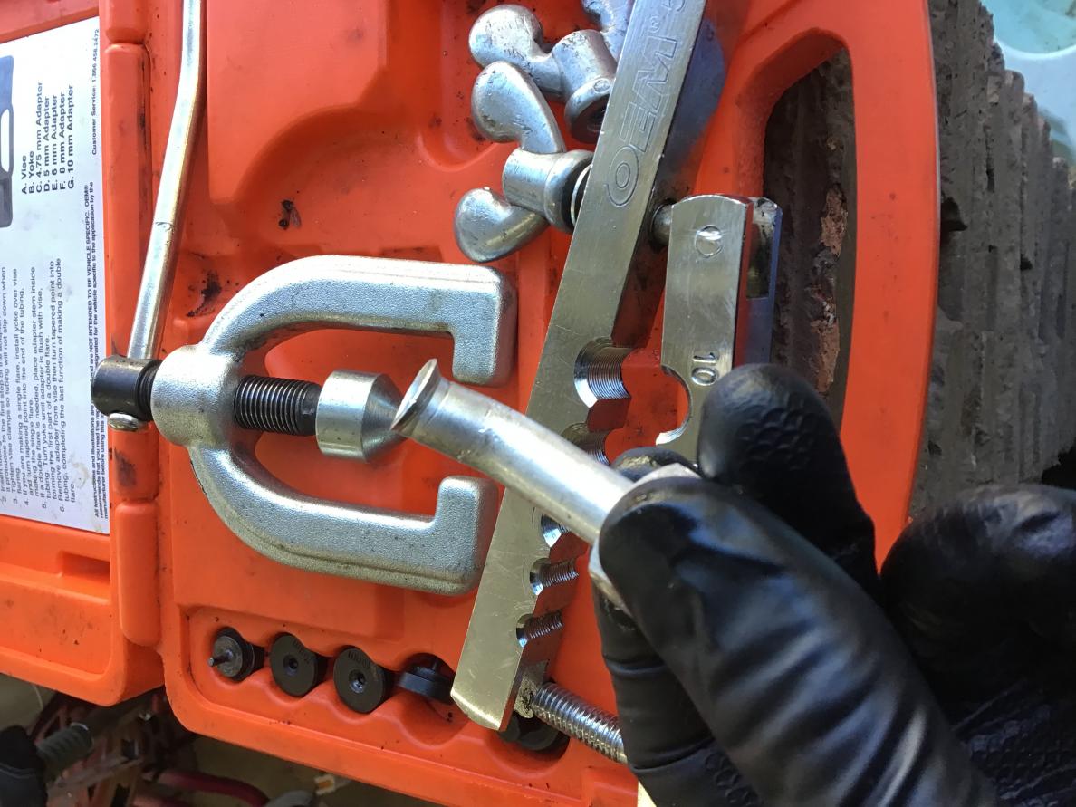

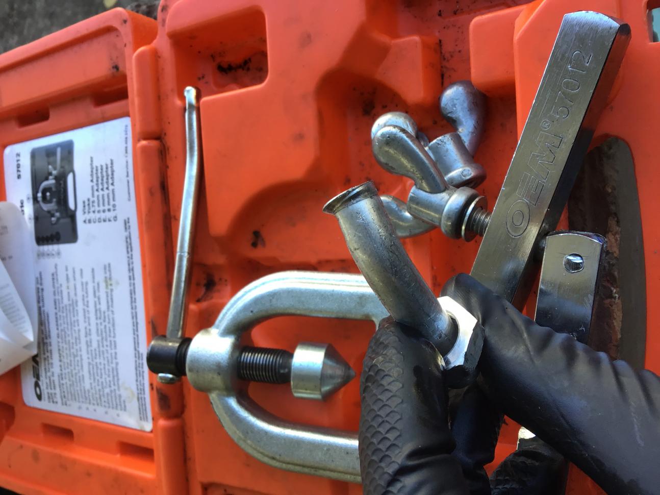

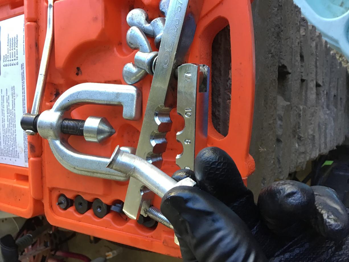

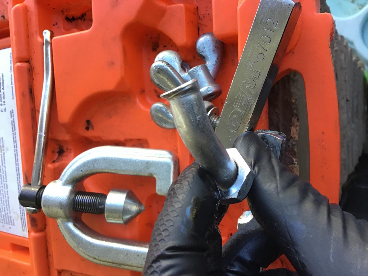

Another post about the crappy quality of the Denso radiators. I bought a Denso replacement from Rock Auto for my wife’s Acura MDX (purchased it before I installed the Denso radiator on my 4Runner). Finally got around to installing it the other week. Much like the 4Runner version, this Denso radiator just felt flimsy and cheap compared to the factory radiator I took out. Her MDX has a transmission cooler in the radiator just like our 4Runners. After I got everything back together, I noticed a steady drip of transmission fluid every time the engine was running. I tightened the fittings on the radiator, but the leak persisted. So I unscrewed the leaky fitting completely (they’re not the press in type fitting like the OE radiator had) and found the a terrible flare on the compression fitting they used. I cut it off and reflared the fitting, reassembled, and the leaking stopped. This just re-confirms to me the crappy quality of these Denso radiators.

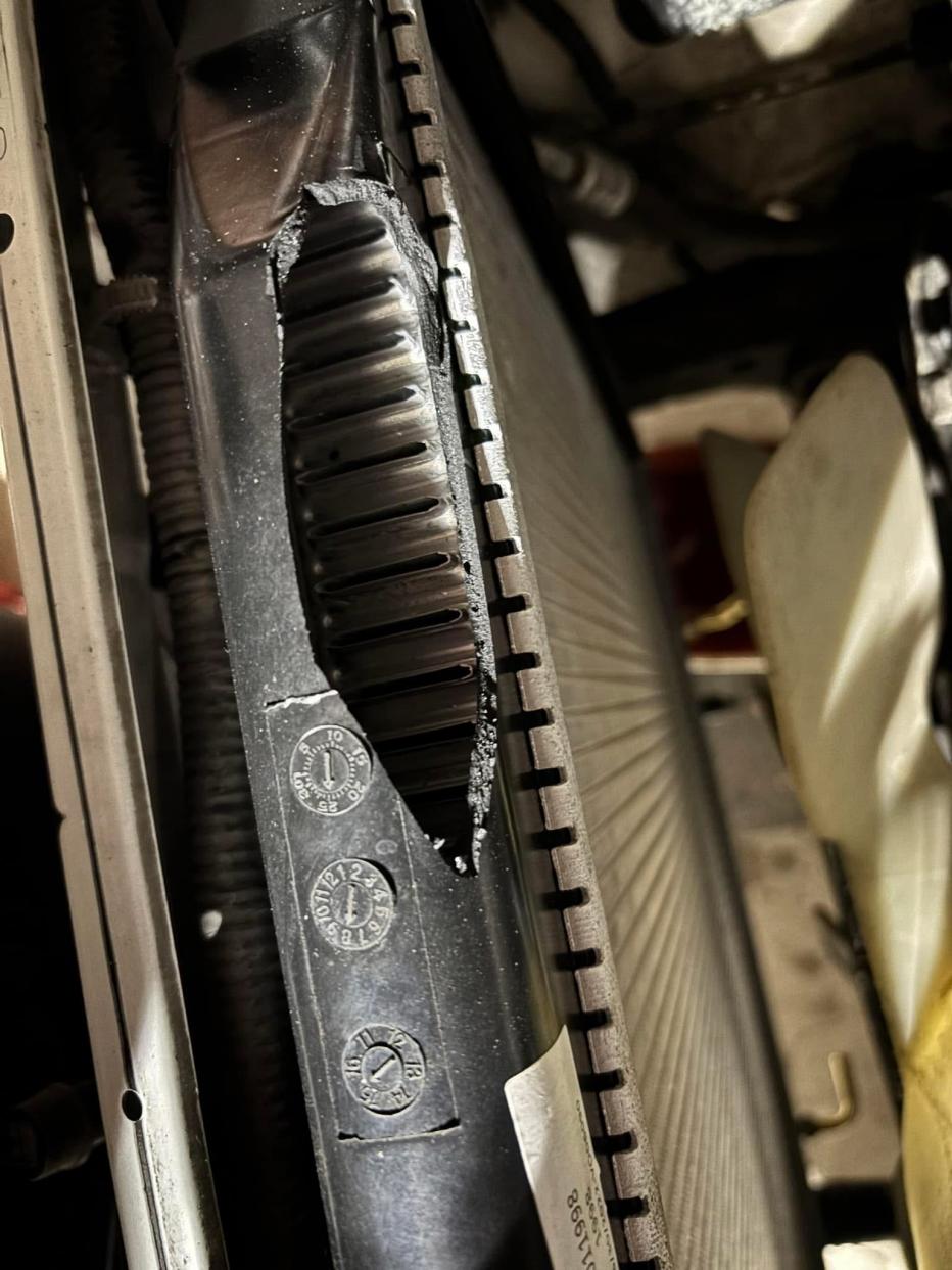

Not my picture, saw this in one of the FB groups. Guy ripped off the upper radiator hose port trying to wiggle the hose off his new Denso radiator. Apparently he put the hose on backwards and was trying to take it back off to flip it around. These Denso radiators are garbage lol.
