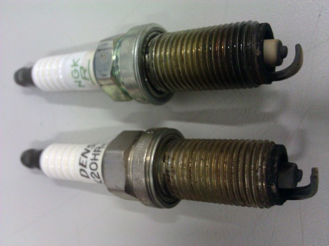

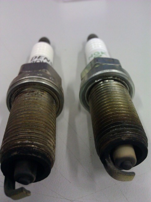

What plugs look like @ 83K Miles
Just wanted to show and tell -- my first post here. Found a lot of great information on this site, thanks to the T4R community!
Got my 2006 4Runner in May with 79,000 miles, now up to 83,000. Confirmed plugs were never changed, Denso on pass side & NGK drivers side. Just went with the recommended Denso K20HR-U11 for replacement. I feel like the 4Runner is running more smoothly and a little more throttle response. Hopefully will see an improvement in MPG.
