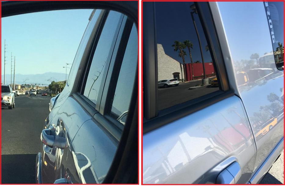

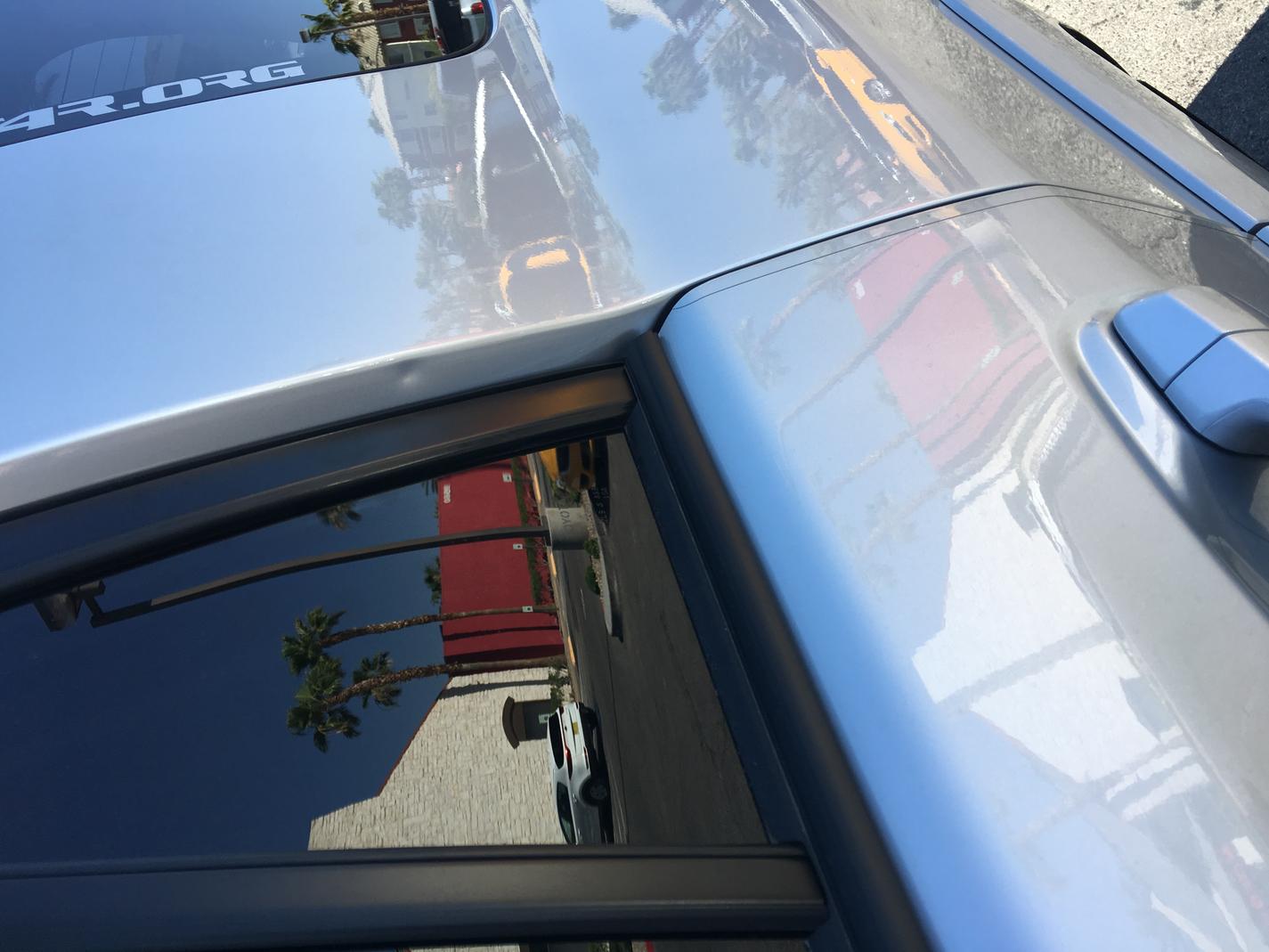

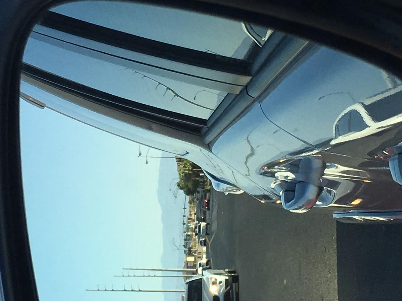

So this happened today. As if I didn't have enough issues with the tailgate I guess someone bumped/whacked my car and dented in the parking garage. Paintless dent guys weren't able to do anything. Glue wouldn't stick and while they tried to get a tool up thru the hole behind the striker it just just ended up getting caught on internal body parts. They said drilling a hole was the only way to get in and I won't do that. Any suggestions? Can you get to this area from inside behind the trim panels or am I stuck with it?

Do you have any better pictures? Hard to tell where exactly it's at being zoomed in and sideways.

you're not getting that dent out without bodywork and paint
This. The metal is probably stretched, like a BB shot. Even if they drilled to get behind it it would probably still have a wrinkly look to it.
you could cheaply sand the area down, put some filler and then have it painted.

Haha. No not quite that talented. I guess I didn't explain the pics very well. It's just one dent on the left side of the vehicle. One pic is outside looking at it and the other is what greets me in the mirror.
I'd go by a paintless dent removal shop and inquire....
I took it to the best dent place I know of in Vegas. They tried and weren't able to get the paint to stick. Then then tried removing the striker and going in thru the hole there, but that didn't work. Tool just got caught inside the body and took a bit to get out. They said the only shot they'd have would be to drill a hole in the door jam and go in. Don't want a hole drilled. So I dunno. I'm looking at selling it and getting something I don't freak out about.
I'm a bit OCD about door dings as well as my car. I've had holes drill several times for dings and I'd do it again in a minute for a ding like that.
They put a plug with some silicone where the drill and you only see it when you open the door.
That's the only chance you have at fixing that.
