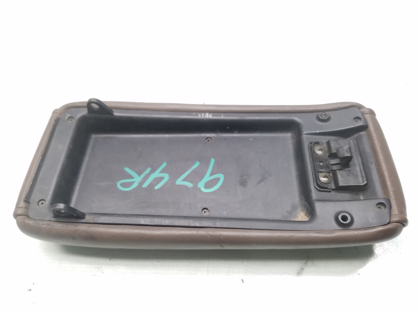

once the top little cubby is removed from the console, there were 4 small screws that held the leather/foam top piece to the plastic cubby "frame". unscrew those and the leather part just lifts off.
the leather is glued onto the lid, and it was glued everywhere, not just the outer edges. so when I pulled it up some of the foam came with it. but to your benefit, if you are replacing the foam then that's not a problem however if you are planning to re-use the old leather, then you will have to remove the foam pieces from the underside after you pull it up. (my leather actually ripped apart and was unusable. I went to an automotive interior place and they gave me some almost matching scrap leather for free)
the screws were just about where the red arrows are in the picture below.
a heat gun will help stretch and form the new leather. i had to fold the back corners like so (below) in order to get the cleanest look possible.
when you cut the leather, make sure to leave enough so the plastic "frame" is screwed back in place it clamps down the edge of the leather. (this will become obvious when you remove it for the first time) it makes for clean edges and helps keep the leather in place while the glue is drying.

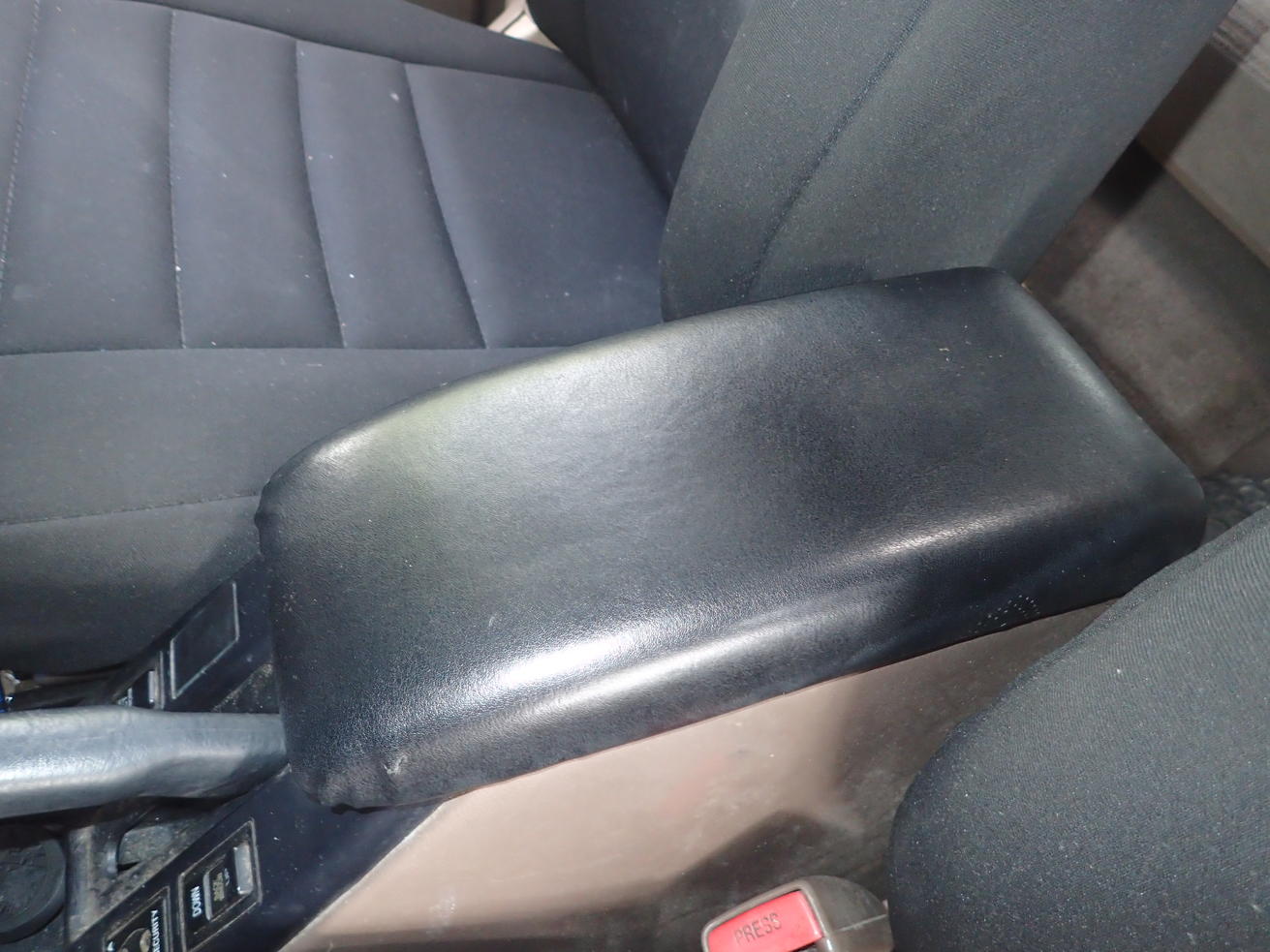

I cut up my wifes favorite black leather purse to fix mine
