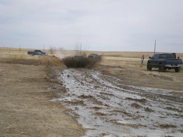

the mud pit was fine, no one had gone through it yet so we had to stir it up a bit before it was really much for mud
