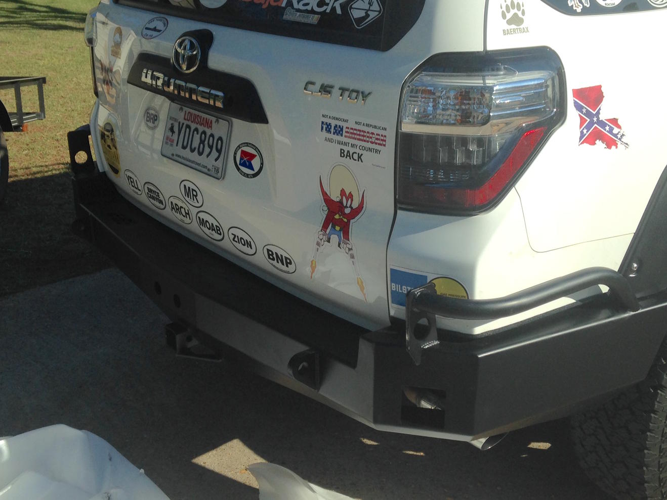

On the rear bumper I have we cut the whole rear crossmember out and integrated a new on in the bumper so I will assume if you do it correctly, it will increase departure angle. If you do it wrong, you will have a weakened rear crossmember.

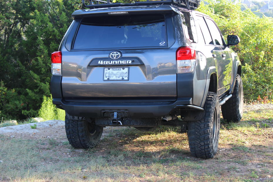

Ah. I was just after departure angle like you. The spare stays where it is. I did use a Beavertail receiver extension for the past year to help with it though. And help it did! In fact it is still there now. Take care.
I've done a bunch of departure challenged wheeling in my 5th gen. Yes, the rear hitch can hit, but who gives a crap. It can take the beating... The area of concern is the corners, not the hitch. I welded in tube support and cut the trim pieces back. Problem solved... I also run a skidmark on the hitch to give a little more protection.
Anyway, I have better clearance than most plate bumpers (with 4x4 labs being the exception) and no additional weight to lug around. Been really pleased with it.
The skidmark takes a bunch of hits each time I go out pushing it... My tubes have also taken a few hard hits, but the plastic cover is damage free so far. You will find that proper technique to clear difficult break overs ledges via angle of attack... will mostly expose the corners. Straight on attempts to difficult obstacles will mostly just have you hung up on the rear LCA mounts.
