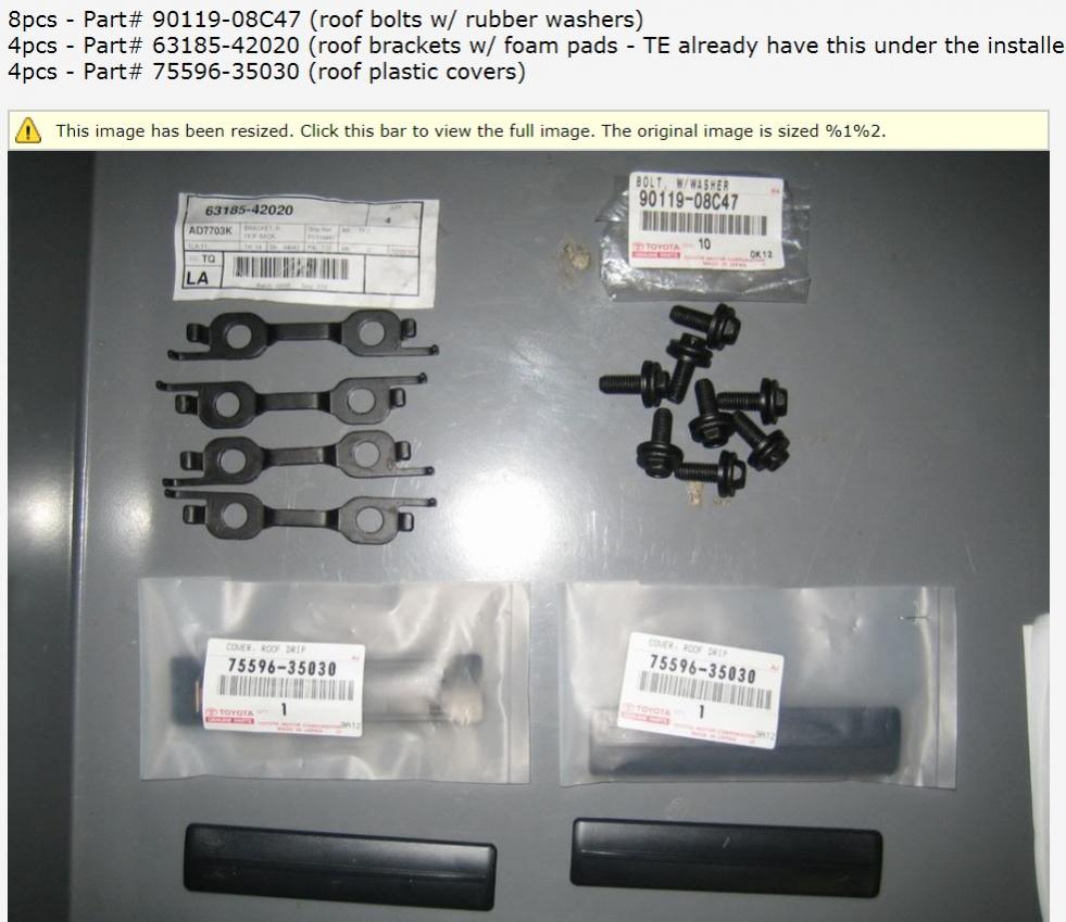

Image is from W8kbrder who did his 5th Gen and posted info.
My end caps are terribly brittle, broke another today while painting mirrors just putting a blanket over it. I also like the deleted look.
Has anyone deleted an 04 roof rack, I looked at the hardware used and the website oempartsource.com, mentor ohio said it did not fit my vehicel but then again my vehicle did not come with the hardware. 5th gen t4r's use the numbers I have for roof rack delete and i am trying to find the hardware for an 04, but I have been unable to find it.
I went back to that website and input the part number for an 04 end support insulator, the part the mounts to the roof and the roof rack sits on top, the part number for an 05 end support insulator is not the same as an 04.
Thank you Bossman . In case anyone wants those parts from the links they are the same as the above image.
04 Sport roof rack delete
Seems that my effort to delete the roof rack on our 04 has come to a halt.
The part numbers as noted ( 75596-35030 ) on the kits are not the same for our 04.
