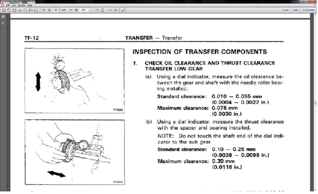

Harbor Frieght wouldn't be a bad idea, my only concern is how long and how accurate the dial gauge is. I genuinely haven't had that great a experience with the level of precision that FSM page is showing. They are asking for about ten thousandths clearance and that is pretty rare for a automotive application from what I remember and I'm not sure I'd trust a Harbor Freight set to be that accurate, most of their equipment is very loose around .001 and even though some Digital Calipers say they measure .0005 I wouldn't trust it (even my Mitutoyo ones)

Its pricey I know, but you're not going to find .0001 accuracy that the FSM is calling for on the cheap. I doubt any dealership has those type of tools. You could try and get by with a .0005 Dial Indicator for about $127
That's a really good point, Blackworks, I hadn't realized how tight those tolerances were.
Like I said, you can probably get by with a very accurate .001" dial since you have about +/-.001" to play with, but I genuinely would feel more comfortable with .0001" if I was doing it; the extra $70 is worth it in my mind to be sure I am doing it according to the specs (even though they seem very conservative.)
