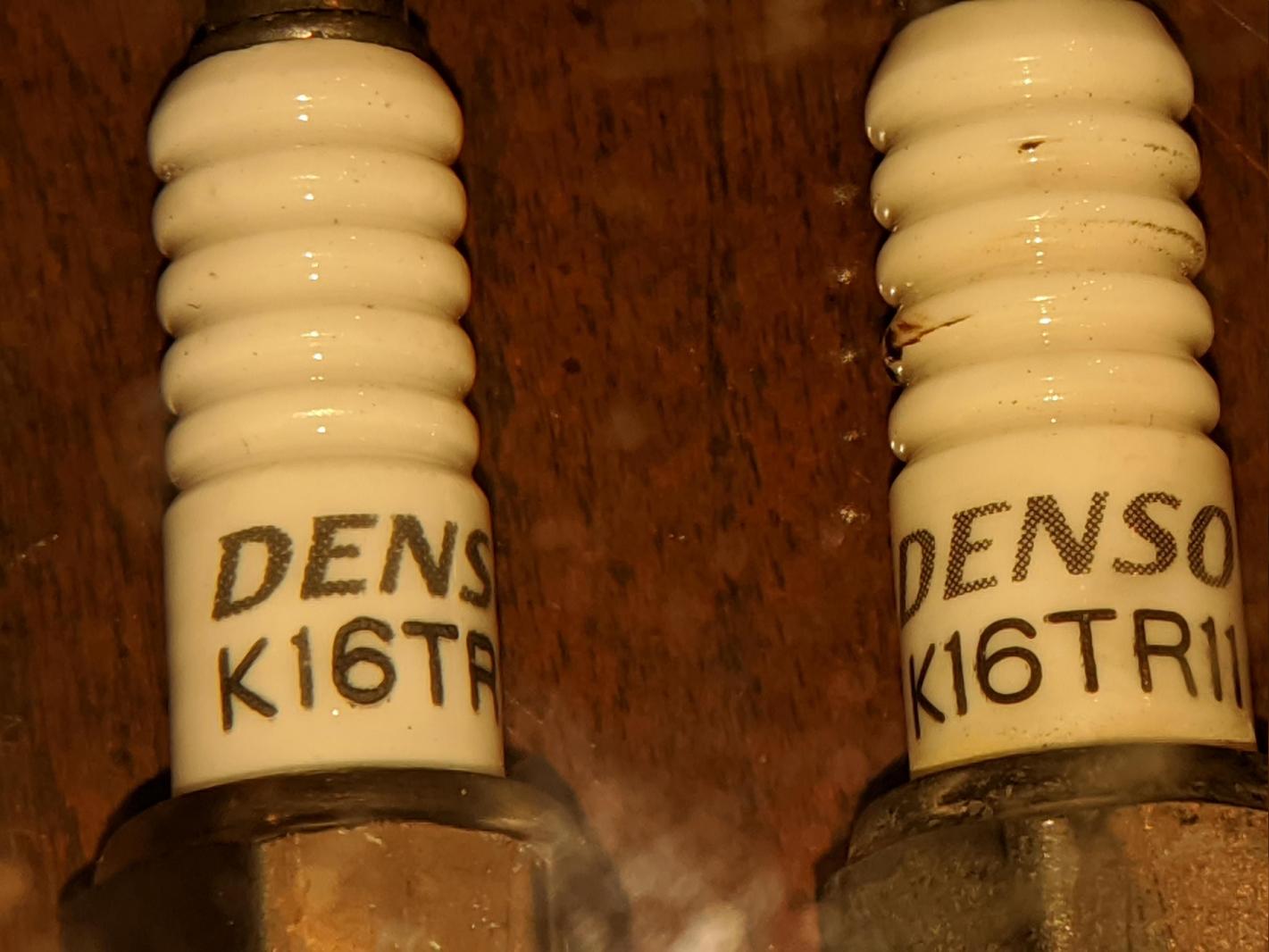

The item I bought: I thought they were DENSO plugs, came in the little red and white lexus/ toyota box. I have been having a misfire issue since then, and I have begun to second guess them.
I'm going to go ahead and pull one right now and check em.
Pardon it being upside down - but you can see the difference in the checkering with the old and new plug, and the font of K16TR11. I think these are fake.
If someone could confirm that would be nice, but it seems likely that this is a "learn from my mistakes" type thread.

Yea, those look more like the old ones than the new ones. I may throw the old plugs back into the car and see if it fixes the problem. I didn't have issues prior, I just changed them out for preventative maintenance.

It also looks like the label is crooked

One thing to keep in mind. Toyota oem densos used to be made in Japan. Now they are Indonesia or some nearby country. This is getting them from the dealer. The switch happened about a year ago. This may make them look a bit different.

I switched the old plugs back in and boom, no more misfire.
I can't imagine it being anything else, but I think the ones I got are just straight counterfeit. I didn't think I would get burned on these - how much can you make on a counterfeit $5 spark plug: the fancy iridium ones sure, but these?

No. The ones at the dealer now say made in Indonesia.
Thanks - these say "made in Japan" on them. I'll probably go to the dealer and get new plugs and compare. Maybe the tooling has been changing and I just got a defective one, but I think they are probably just fake.
