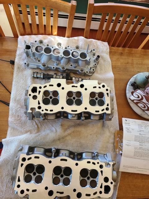

I have the heads on my dining room table so let me know if you have questions that I can answer. Visual answers are MoBetta than bunch of words!!
Before anyone wonders, yes, I AM divorced. :-) I also use the dishwasher to wash car parts.

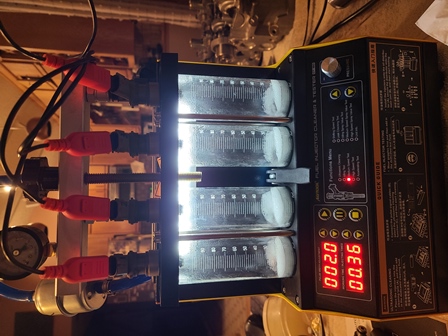

Another thing might be the injectors. Couple of them might be leaking and dripping when they're not suppose to. This is an easy fix but to remove them requires a fair amount of work. The odds of three injectors leaking is quite low but maybe the wiring to them is suspect. While doing my daughter's head gasket project, I'm also cleaning/testing her injectors. Yup, on the dining table!!
