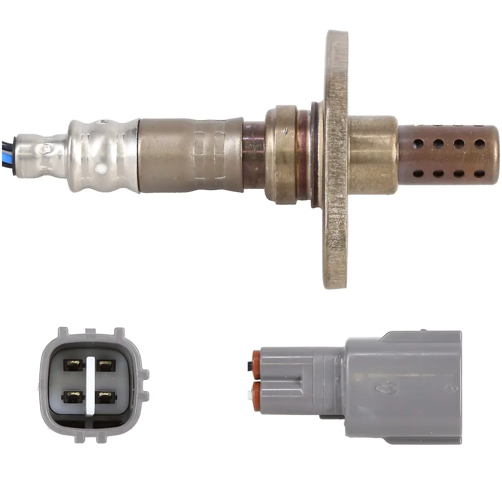

The Denso web site shows you what the plug on 234-4162 looks like:
1500
It also confirms it is the correct upstream sensor for a Federal (non-Cali.) '99 4wd Limited (Auto)"
234-4162
Engine: V6 (3.4L)
CC: 3378
1
Note: 4WD; Exc. Calif.; Auto Trans
Label: OE Style
Position: Upstream
Looks to me like you got the correct234-4162 sensor and your factory plug is for a Cali A/F Sensor. Are you sure your upstream and downstream plugs are the same? Because that plug on the right should not fit where an O2 sensor is called for.
