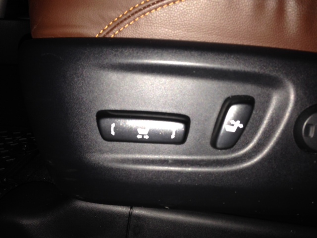

This may help explain such a technical issue: Lifting or lowering the rear part of the rectangular knob raises or lowers the whole seat, and a little forward when raising. Lifting or lowering the front part of that knob tilts the flat part of the seat. Notice how many times I said knob?
My SR5 controls look exactly like that. I can press up on the bottom center of the rocker switch and it moves the seat up and kinda forward. And the LE did not work the same way.... sooooo I a s s u m e d somehow it had been changed.

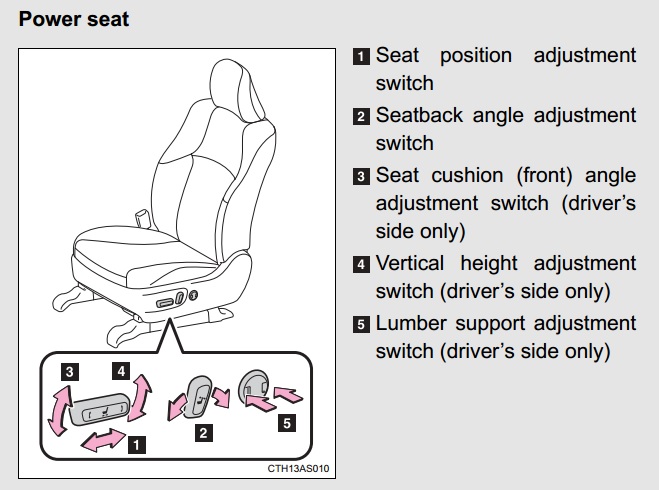

here you go straight from the 2014 manual.

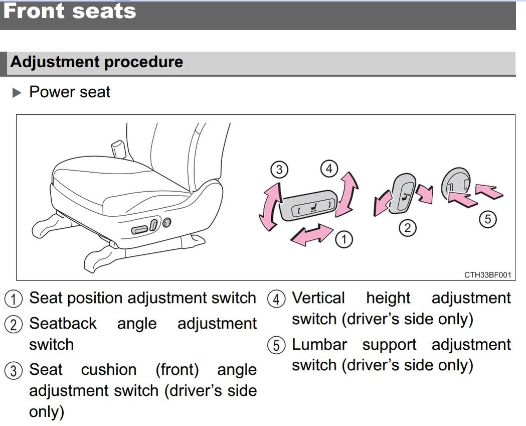

Maybe the '14 LE you tested doesn't let you simultaneously press the entire bar upwards like it does on our older models? ie. on ours if we pull the entire bar straight up the front and the rear motors raise the seat simultaneously, making it feel like it's going straight up. And perhaps on the one you test drove, it locks you out of doing both at once :noidea:
Our manual seems identical to what [MENTION=1032]NoDak[/MENTION] posted:
