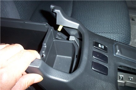

Ray -
Took a look at the truck, and it appears that the installation requires removal of one bolt in the console box, then to pop off the rear and middle console pieces. Is there anything else required to install?
Thanks!
NO BOLTS. I think you are looking too far back.
The little open box directly in front of the console box is not disturbed.
The console top you remove wraps around this open box just on the sides. Grab both pieces on each side on box and pull or might have to pry a little.
I will try to send picture sometimes will not work with this site. If you want email at .

The entire bottom center console area (shifter location) is all tabs. Just pull and nudge here and there and it'll all pop out. No screws or anything is needed for this section :)
Pretty easy to remove and clean out the hard to get spots and also easy to do some mods around that area.

OK, I bought the ashtray accessory so I could get the second power port up front.
Took 5 minutes to install, and it works like a champ. :) By the way, the cigarette lighter has a ring around it that lights up when you have the headlights on.
By the way, I finally found a use for that little cargo box just above the cup holders -- it is just big enough for the power cord and headset for the cell phone. :D
