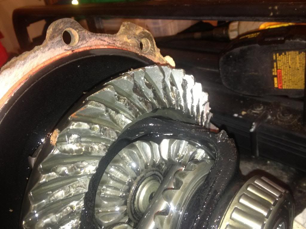

IMG_0691_zpse2aa0553.jpg~original
Ring gear stripped of all teeth....

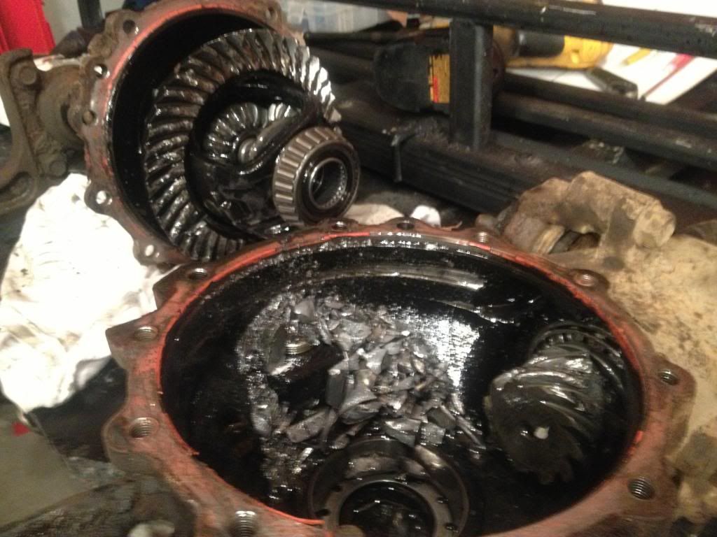

IMG_0694_zps8997ff1b.jpg~original
Pinion and a cup of sparkly bits

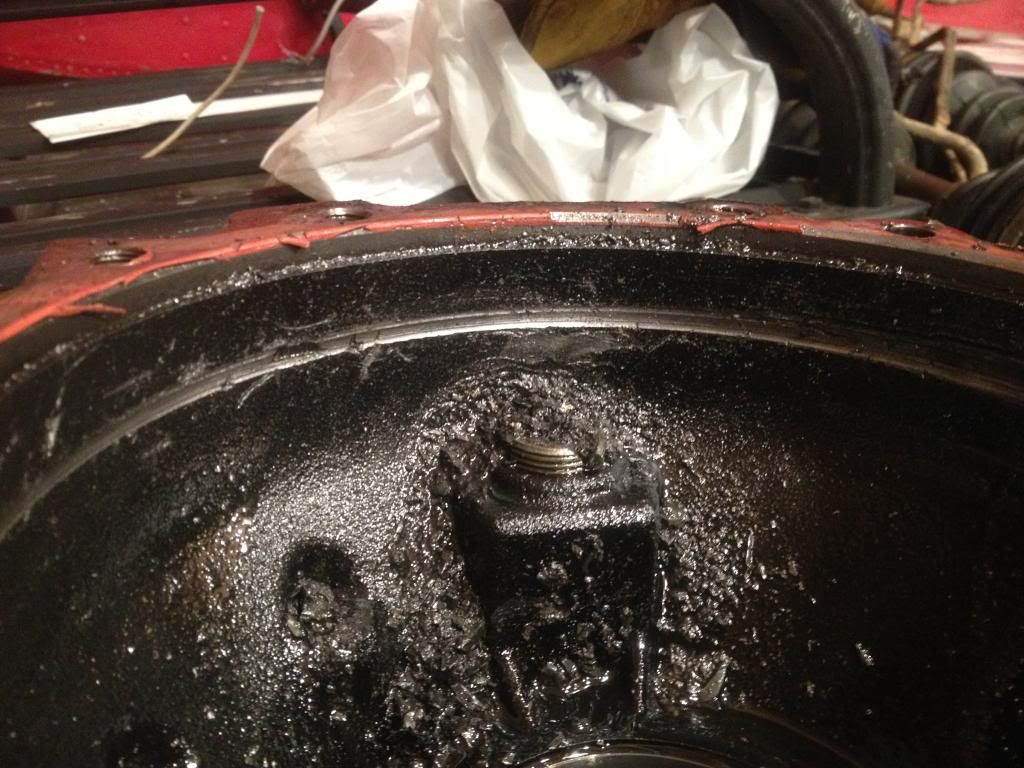

So now I'm looking into the repair. A stock replacement is 600. New gears with install kits for both diffs allowing me to go to 488's are about 800. My biggest concern is the groove in the case. It's up to 1/16" deep or so at its worst. I'd hate to rebuild only to have the case split. Could I weld repair....not likely. I can find a case with the wrong gears for about 300 to rebuild but that takes me to 1100....
