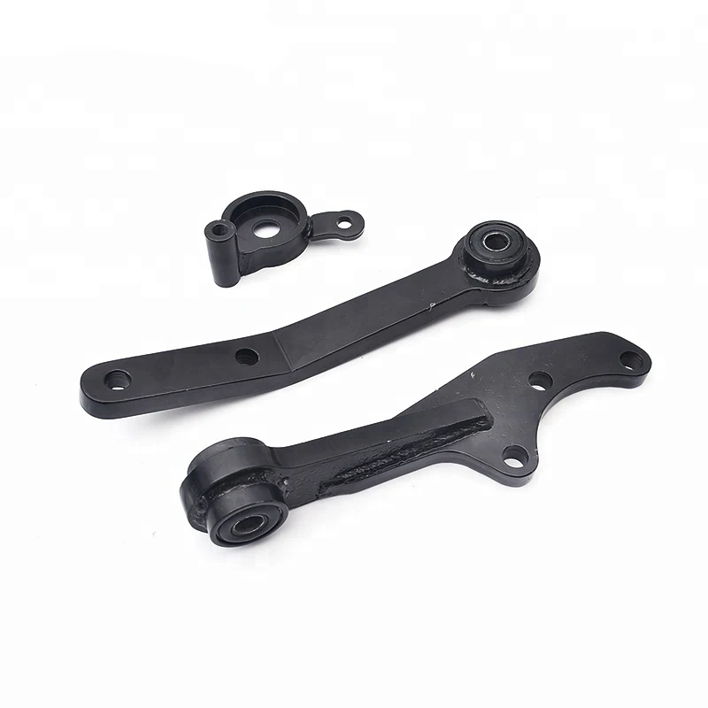

FWIW - there are diff drops that do a lot more good than the typical spacers in terms of actually dropping the diff down an inch or more. I have not personally installed one of this style, but visually they look a lot better than the basic spacer style at moving the diff lower.
