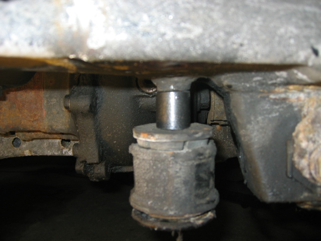

Diff drop will help for the CV joint if you will lift 3". I drove my 4R for two and a half months without diff drop and the grease was spitting out from the CV boot. I installed diff drop and change the locking clips with plastic tie wrap and the grease stop leaking. For another $20 is worth the money. Other places sell for $40.
