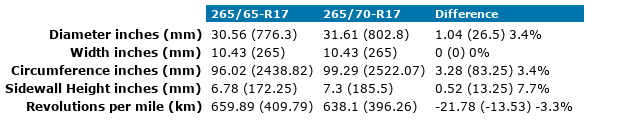

Check this out:
[url=http://www.tacomaworld.com/forum/tirecalc.php?tires=265-65r17-265-70r17][/URL]
Thanks Smobien, that is exactly the input I am needing. I like the calculation sheet there too. That explains a lot. You know, the funny thing is the 70 series is actually about $20 a set cheaper ,where I priced them.

It's a much more common size, so you'll find that the prices may be lower. I have been running the 70 series since 2010 on a set of old Goodyear Wrangler AT/S tires, but I'm now on some 255/70-17 Blizzaks. After winter, I'm likely going to pick up a set of OEM-sized 65-series Michelins. The reason I'm doing this, is that I thought the 70 series Goodyears made the truck feel cumbersome. They were just some heavy tires...the blizzaks are much lighter, and i can feel a large difference in the ride.
When I checked the stats on the Michelin LTX M/S2, the OEM size was a decent amount lighter than the 265/70-17 size. You're going to feel the difference in ride and in acceleration with a few fewer pounds per corner, and I don't think you're losing much, as far as ride height. Mine was a tad bit taller with the 70 series, but I'm not one who needs every last 1/4 inch of clearance crawling over boulders, etc. I doubt many of us are.

Speedo 5% off, ride difference will depend on tire, if u stick with P rated it won't be any difference really. Slight decrease in MPG! Most like the 70 ride better! There are tire size calculators all over the internet, they can guide you
