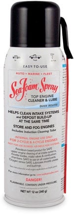

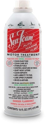

Hey guys. Last week I used Sea Foam Spray to clean the injectors, which cleans and lubricates through the PCV valve. Would it be ok or should I have done it with the Sea Foam Motor Treatment.
Going through the PCV won't clean the injectors. Only dumping in the fuel tank will clean the injectors. What you did was clean the intake and valves.
Thanks cashmoney. I notice that when other members do the sea foam treatment through the PCV valve, they pour the sea foam. They don't use the aerosol with lubricant. Just wondering if I should use the liquid form to clean all the lubricant it left.
So did you use deep creep or the aerosol can of the motor treatment? Deep Creep is intended to be used as a WD-40 substitute and not for cleaning things. The aerosol can is supposed to be sprayed directly into the intake in front of the throttle body plate and not into the PCV.
