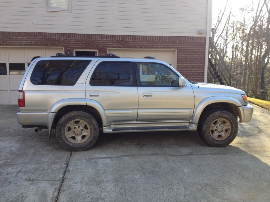

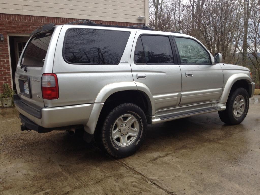

I am very pleased in the 906's compared to the stock rear springs. Not only does it give the truck a better look but it rides a whole lot better. I remember measuring the rear trailer hitch before putting the springs on and it was aprroxmately 10/6 inches of clearance. Result of the 906's is about 16 inches, it's a little too high right now but I know over time the springs will settle down to probably 14/5 to 15 inches.
The rear is too low...

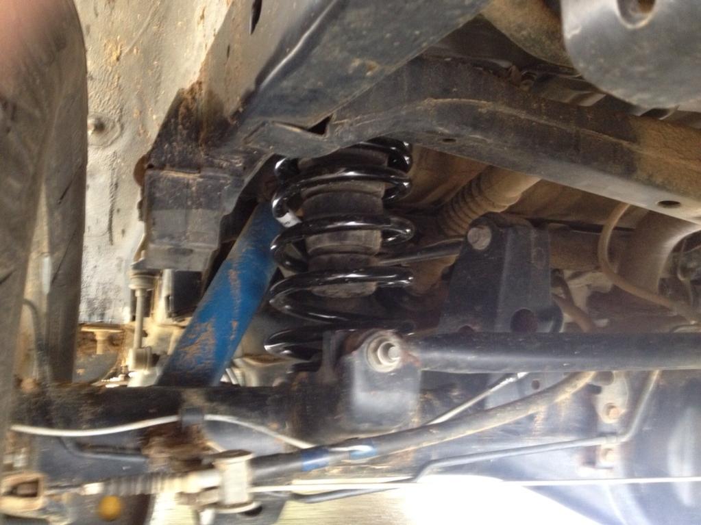

The main reason I got these coils is to get these stinking bump stops of that freaking axle! There's actually a good amount of travel.

It looks much better. Over time the rear will probably drop 1/2", but not more than that, at least in my experience. If one is not going for a serious off-road upgrade using LC 861s or the like, buy a pair of 906s.
The only drawback in three years is that the rear became stiffer with the installation of the 906s so the ride is a little more harsh.
