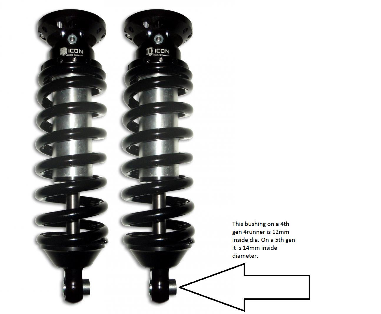

The bolt on the lower control arm in a 4th gen is IIRC 12mm dia shaft. The 5th gen uses a 14mm shaft bolt for the bolt to secure the coilover bushing to the lower control arm. So the answer is technically - no. A 4th gen coilover will not be a direct fit. However, if you have any of the ones that use a spherical bushing with misalignment spacers, it's a matter of buying different spacers. For Fox suspension it cost me $9ea, or $36 total for the correct spacers. I have a set of older Fox 2.5's from a 4th/FJcruiser in my 5th gen I bought because they were $400 for the set. Otherwise they fit as normal. The top end was correct and length was okay. My only issue was that to set at stock height I was at the very limit of the threads on the coilover. I could not go any lower than maybe a 1/4" lift. I don't know if that is due to a slight difference in geometry or just normal for the shock set.

4th Gen has slightly smaller bushings on the bottom where it connects to the lca. Get bushings for the 5th Gen, press them in and bolt up.

No. Read this thread from the beginning. The lower bushings or misalignment spacers will be the wrong size. They are generally swap-able for the correct ones. Call ICON and have them send you the right parts and they will transfer. For FOX shocks it costs about $40 total. Fox tech support told me that even a 2014 won't fit on a 2015, but I suspect that ICON may have more knowledgeable tech support. If they say no - call a suspension shop like poly performance.

This image might help:
