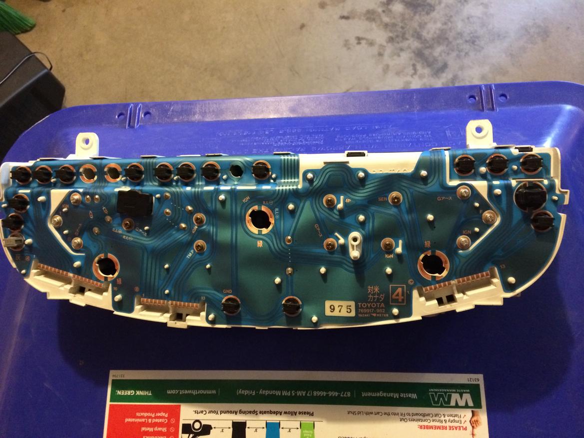

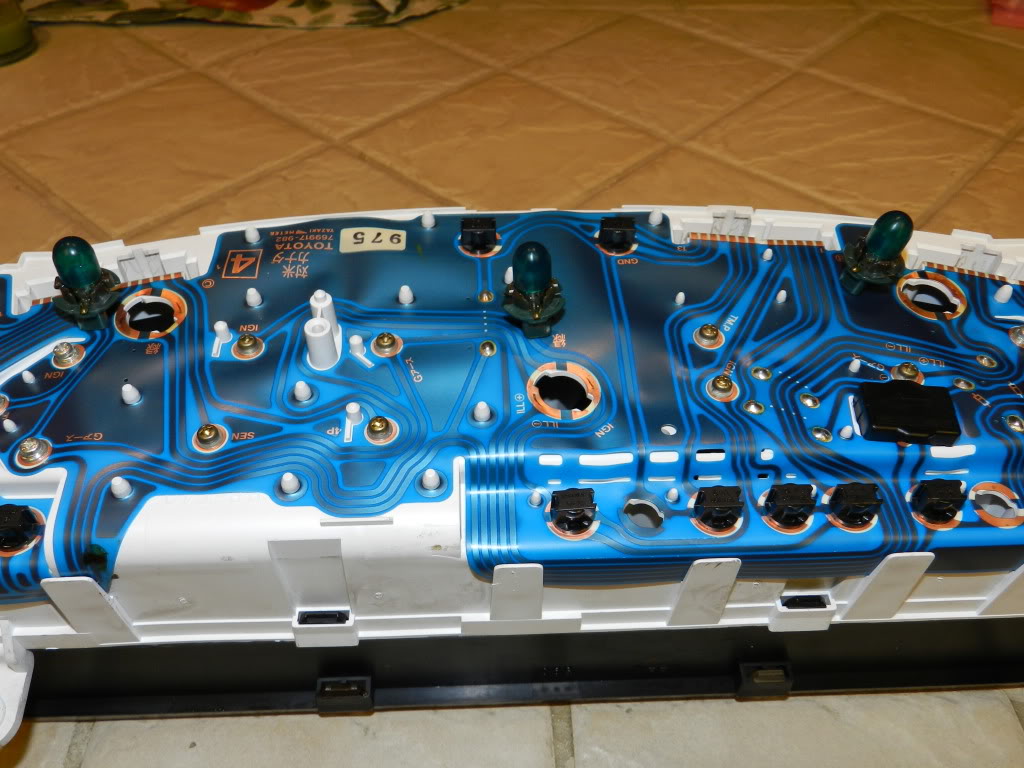

Also found the picture below with the light bulb locations. It looks like the big three lights are 194s... trying to figure out what type lights are the smaller ones located in the bottom row (where the ECT light is located).

I just replaced the overdrive light in my 97 SR5's cluster and it was a 2721. Same as the ashtray and glovebox lights.

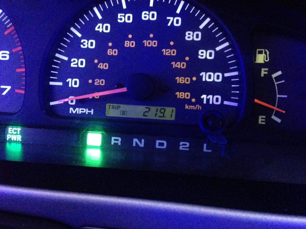

The ECT works fine... it was just a burned out 74 lightbulb. While I was in there, I replaced the old incandescent bulbs with new stock bulbs. Didn't feel the need to 'rice' it out with LEDs; the new bulbs are so bright I do need to turn down the dimmer a bit.

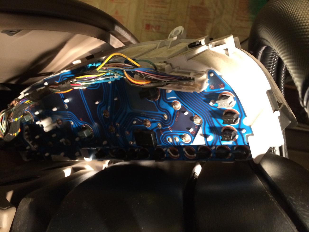

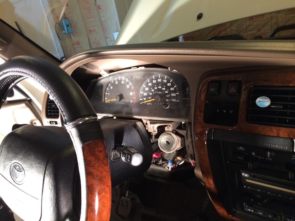

I followed the link I posted above with text directions on how to remove the instrument cluster... wasn't too bad, even for a non-mechanic like myself.
It was no big deal to roll the little green plastic jackets off the 194 main bulbs and roll them onto the new bulbs. I thought they would be old & crusty, but they came off fine.

Got in my 4Runner the other day and noticed the ECT light was out (I keep it on 100% of the time). I think my bulb burnt out I am going to check it out later today.
