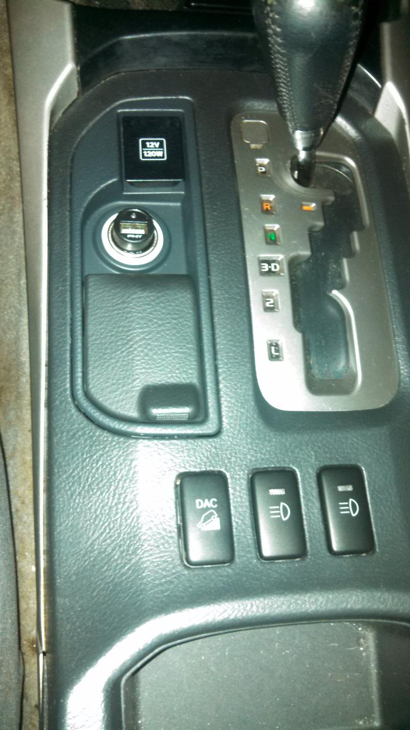

I picked up a couple of FJ switches and installed them in the blanks in the console.

I actually just did this mod a couple weeks ago on my wife's 4Runner.
Here's the part numbers for the FJ fog switch which fits perfectly in an empty slot to the left of the steering wheel or in the center console (It also has an indicator light)
One is the switch and one is the harness that it plugs into.
PT297-35070-AS
PT297-35070-SH
My local dealer price matched this listing for both (cheapest I found at the time): http://toyotatrdparts.com/Scripts/prodView.asp?idproduct=-59
