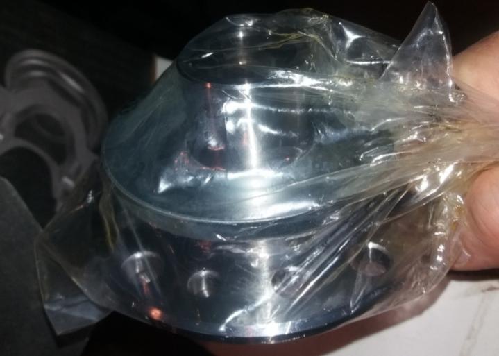

While all you are doing fun mods, I'm fixing leaks.
I'm fixing the diff leak that I half fixed last year with only the seal. I needed a new flange as it was ridged from the previous worn seal. No more gear oil on the muffler after this goes on this weekend.
Well I got it apart quickly, the old seal out, and the new seal in, but the flange ended up having a diameter 1mm smaller and would not slide onto the shaft. Also it was 1mm smaller outside diameter so no way it would seal if it did slide on.
Rock Auto issued a refund plus paid for their part to ship it back. I opted the the cheapest part and got bit. Maybe I'll pick up a Toyota part next time. At least the new seal should hold for another year until I really need to get to it again.
I looked back at the rock Auto order page and the only difference in all the specs is one indicates 1.50" shaft and one is 1.64". I wish I would have noticed that. Why on earth would they make identical parts that are barely that different, but listed to fit my car?
Ahh shoot. Now I have a bad rear end whine. I thought it was just a little low on fluid, which quieted it up in the past, but maybe I made the pinion nut too tight?
Wrench only went to 150lbs and I pulled just a little more.
Thoughts?
Meh. Taking it to have Toyota fix on Monday. I don't have a garage to fix it and I've been making 2.5x what I normally make on unemployment, so why not have it fixed right. I've never done any rear end work, only engine rebuilds. Made it 20 years without a dealer repair as well so not too bad.
Well I got an entire new pumpkin. The tech showed me the rear end with the driveshaft removed and it was stuck as we tried to spin it. Something was shot on the inside. I opted to replace the entire gear set assembly for 2500 vs try to diagnose and just replace the pinion bearings for 1200.
