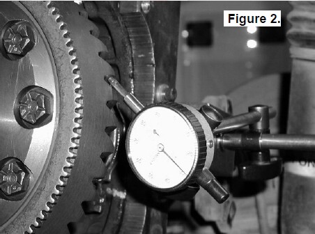

I agree with brain2sun, this sounds like an incorrect backlash scenario. This pic will help you understand exactly what that is, if you don't know. When the diff is rotated back and forth a little bit while the pinion is held fixed, the dial indicator will produce a measurement of how far the ring gear teeth can move before they contact the teeth on the pinion. If the value is too high, then the teeth will smash into each other too much and probably not at their strongest points, or if the value is too small then they can become tight after thermal expansion and be subject to high stress. Either way, stripping the teeth is the usual result.
