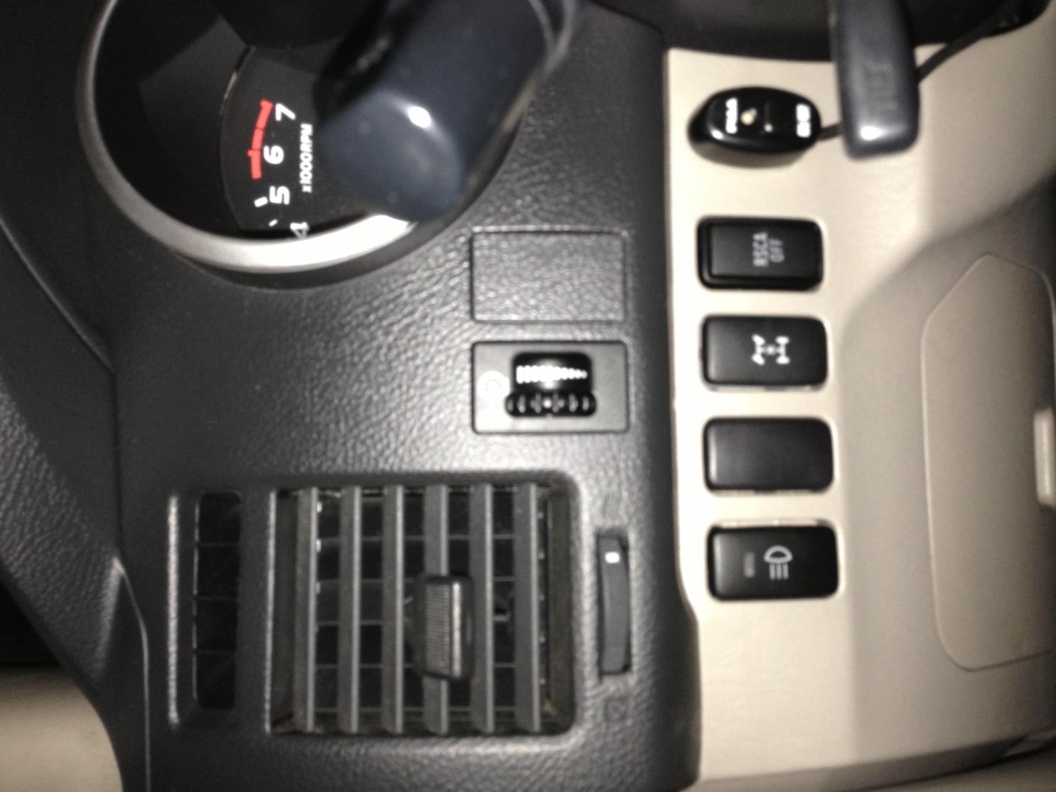

Don't know the part #. I have a empty spot next to my
dimmer not sure what option goes there. As far as the other empty
button locations I think you would have to cut the plastic to get it to fit.
What year is yours? I don't have that extra slot. But another question. That light button. Is that for your fog lights?
