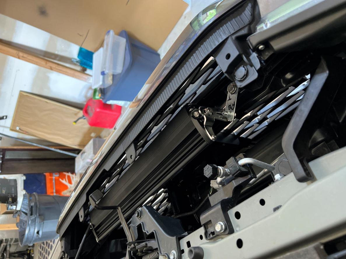

Quality: I have both a Lasfit and Auxbeam light bar, even though for the price I'd say those are quality light bars, but the DD light bar is built better. The DD 18" Stage Series bar heavier than my other light bars, and it is by far the brightest light bar I've tested to date. The mounting brackets and how you adjust the aim or how you level this light bar is amazing. It has a pivoting mounting point on the back, and the front brackets have a slot for it to pivot and lock down. Once its locked down, it won't move.

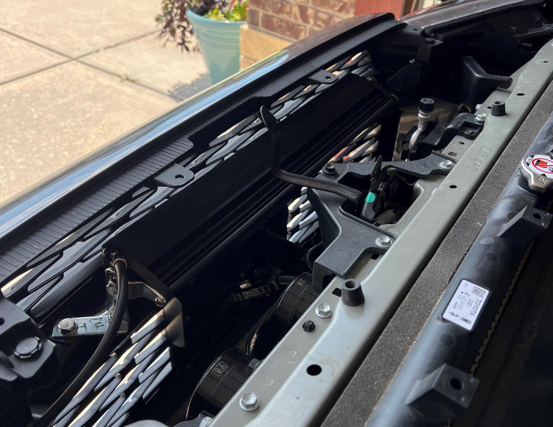

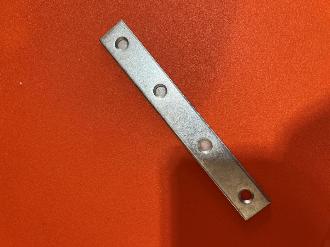

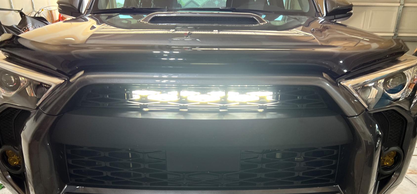

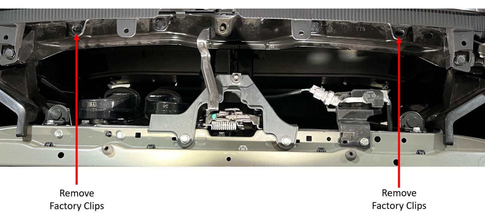

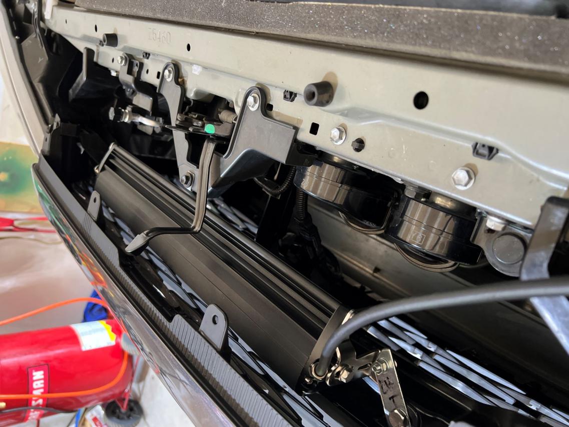

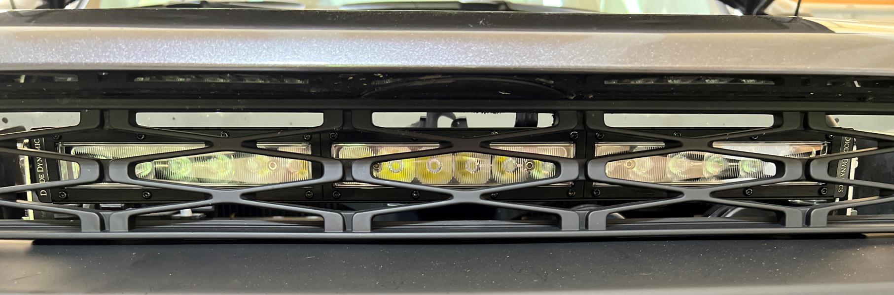

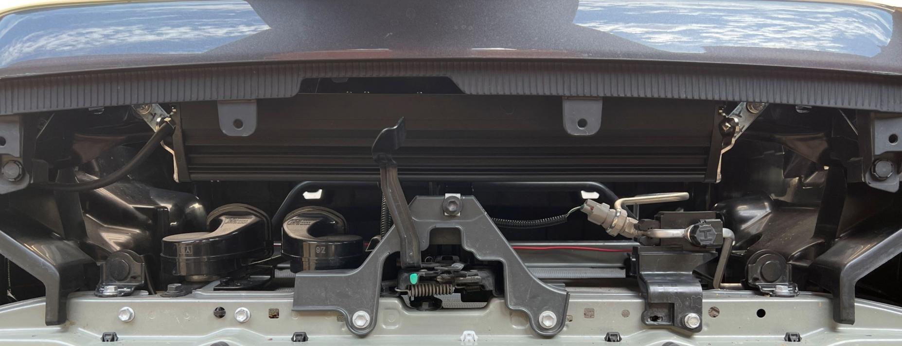

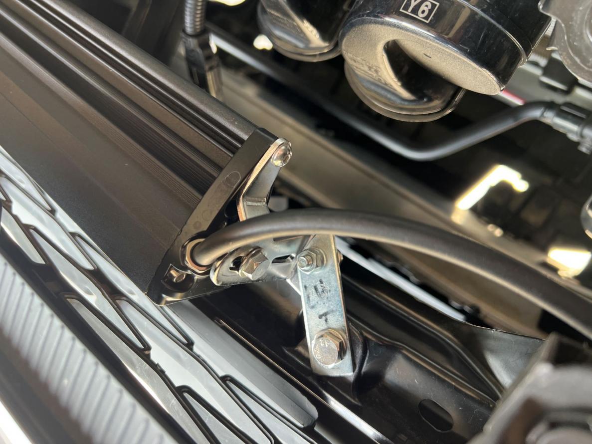

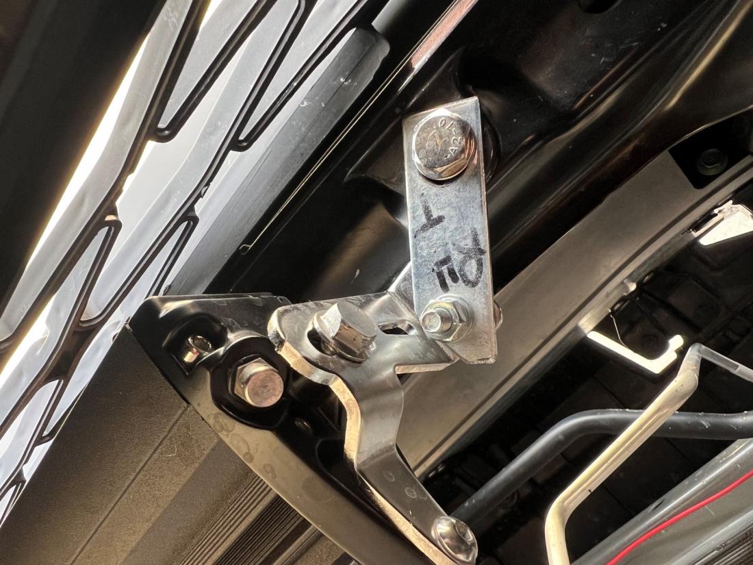

Bracket/Mounting System: I was able to use the factory holes used to hold the lower grille portion to the frame bar just below the upper grille (see pics). I removed the (2) factory clips and installed bolts in that location. I purchased a steel mending plate from Lowe's, and cut the metal to fit. I did drill out the mending plate holes to a larger size for the mounting location on my 4Runner, the other hole sizes worked great for the light bar mounting bracket. From there I just adjusted the light beam height to my desired angle. Please reach out to me, or message me on mounting options, or how I came to this mounting location. Also, I didn't need to mount this light bar right up against the grille since the beam type is driving. If you choose a flood type pattern, you would have to change the way you mount this to get it as close as possible to the back of that upper grille piece. Combo might be the same. I choose driving because of my other aftermarket lights. As you can see, this light is perfectly centered left/right & up/down.

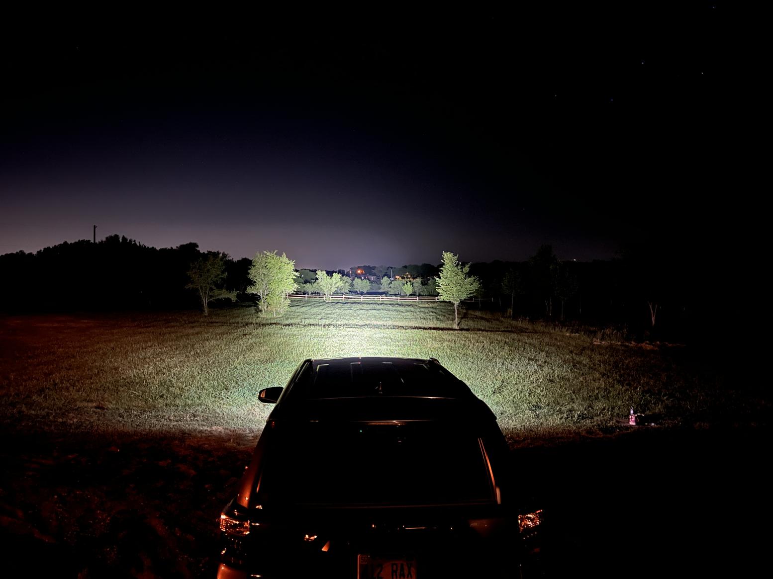

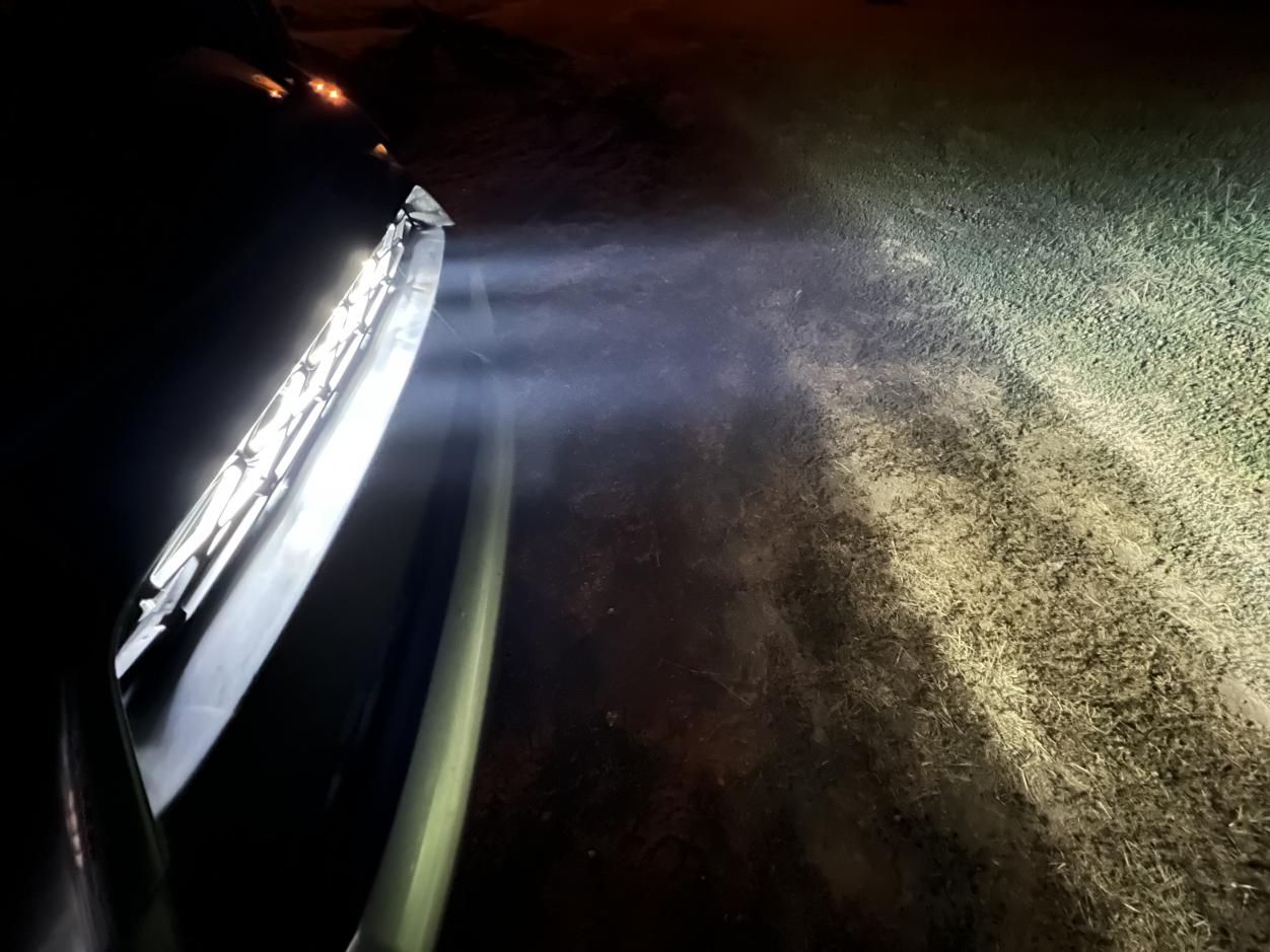

Performance: Now the factory LED High beams on my 22 ORP are really good. However, I got way more distance and light with this DD light bar. You'll see in the picture, the wooden fence is at 100 yards, the next set of trees is 250 yards, then if you can zoom in, see the brick house in the back! That is over 600 yards away! None of the other light bars even came close to this performance, and they were 22" bars, this is only 18"!

How stable is that mounting solution? I’m interested in doing the same but worried about wobble.
Hello, the strap is over .100" thick strait steel. I purchased 2 straps so I could double them up if I needed to. When I mounted this, I didn't need to double up the material. Its solid!
